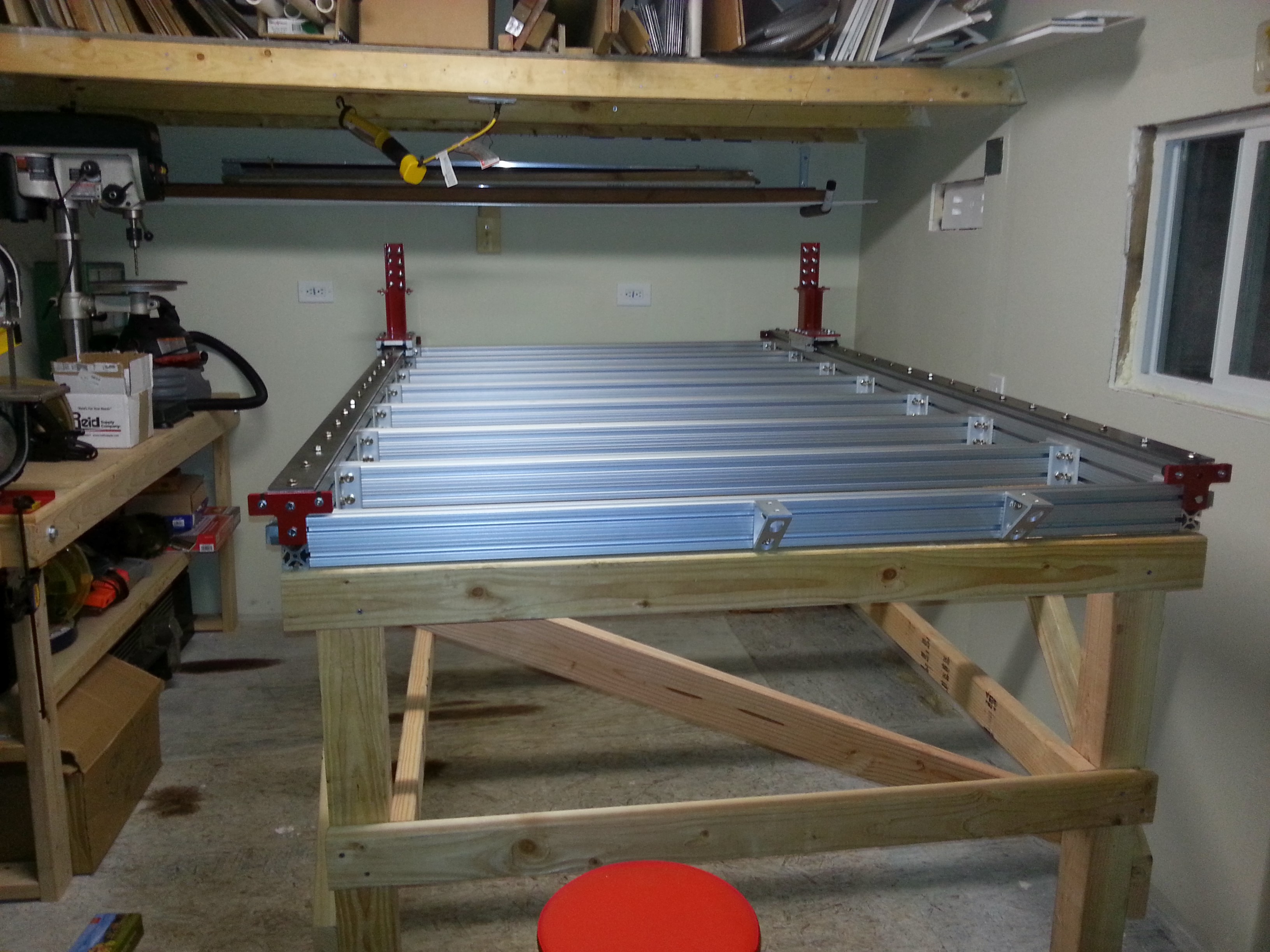

Got my x-axis frame complete.
Got my x-axis frame complete. Just finished building a wood support base for it with adjustable feet for leveling. Takes up most of my shop but that’s okay. It’s getting there…
Looking good
Are you using http://cncrouterparts.com parts?
@Richard_Betel - yes.
I have the same table in my garage. Just food for thought, my X motors hang out about 6" beyond the steel tracks and my z motor runs up to 18" above the gantry.
@Granger_Davis - thanks for pointing that out. The length is something I can’t do anything about but it should be ok. The height might be a problem because of the loft. If it is, i’ll have to cut the table legs down. Not a huge deal but annoying. I’ll measure how much clearance I have and report back…
Dang. Darn loft. Guess I am going to cut the table legs. Oh well.
