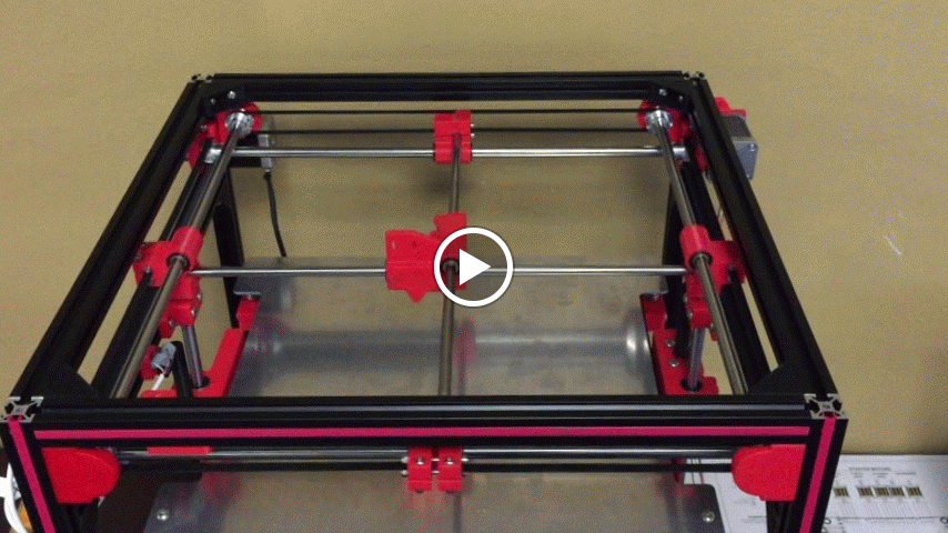

Got past the belt grinding noise and the vibrating… Does this look like it’s working well?
Should I let it run through the entire break in gcode?

Looks good to me. Yes I would run it, multiple times. If you want for initial break in you can put some light oil on the rods during break-in. After that you should be good. By light I mean like a sewing machine oil, or 3-in-one. Then wipe down the rods when done. Also you can turn up your speed multiplier on the second or third run to determine your top speeds, or to determine any additional tuning required.
Was it an alignment issue after all? I was cringing pretty hard at that grinding noise…
I tore it all apart and moved the carriage to every corner and readjusted. I think that the rod that goes across the middle might have been causing some issues by pushing the sliding pieces out of whack. I also have never had the belt in the perfect position like it is now. When I could take the carriage and slide it all over the place with one hand I knew I was set.

@Eclsnowman I will have to spend sometime running the break in gcode. My coworkers love hearing that white noise as my printer runs… So just use some 3 in 1 oil and run the break in code a bunch of times. After that I don’t need any oil at all?

I’ve been running the break in gcode all morning. I used a little 3-IN-ONE oil on it and this thing has gotten quiet. I love it!
@Eclsnowman “Also you can turn up your speed multiplier on the second or third run to determine your top speeds, or to determine any additional tuning required.”
How do I go about doing this?
@bcrazycramer as a reference I can run the break-in code with a multiplier at 200% (300mm/s) with no grind or slip. As you use your machine you will get to know it better. At that point you can tune your machine to go faster.
You currently are not seeing missed steps at the 150mm/s in the break-in code. Know that your gantry is never perfectly aligned. But it is currently good enough that 150mm/s is no problem. Perfection is not attainable, but closer to perfect is with experience which allows higher speeds.
@Eclsnowman Sorry… How do I set it to 300mm/s? Not sure where I set this in Octopi or elsewhere.
So set it to 150% and hold on…
