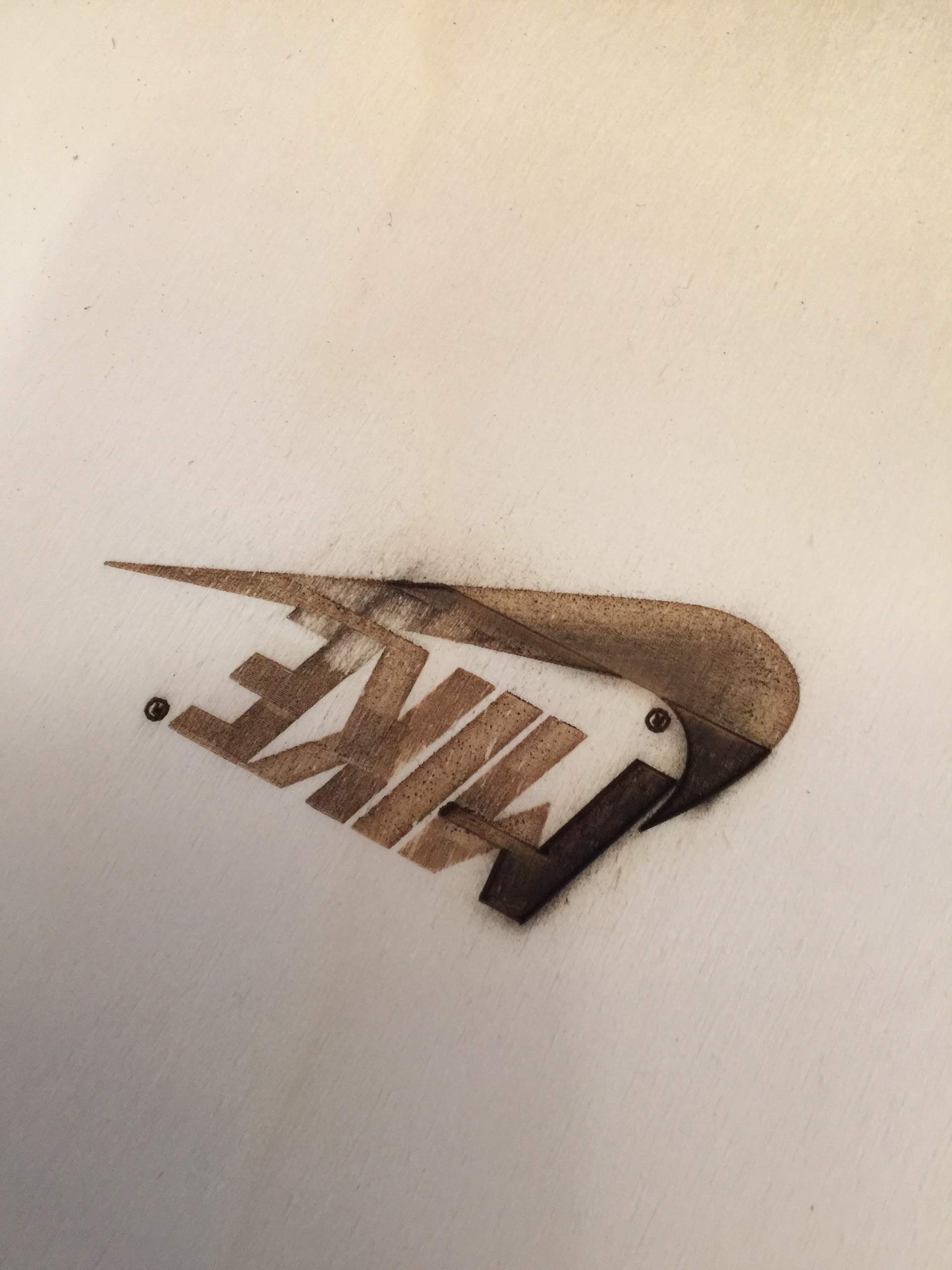

Got some issues with engraving consistency, and at the same time strange smudges appearing on the lens (bottom side)…
(All 1 ‘document’ in LW4)
Any suggestions?

Do you have the compressor running? even if you are engraving you need the compressor on to keep the lens clean, it will also help keep the engrave clean.
That smudge is odd tho. it is dirt? can you clean it?
If you are trying to Raster engrave there is currently a bottle neck with smoothie-laserweb, try reducing the speed below 40mm/s
If you have an SVG the raster fill can operate a lot faster. its really the raster documents and rastering grey scale which is very slow.
Power wise i would have a range of 0-10 maybe less 0-5%
What are the seetings you used?

Using “laser fill path” because it is al vector so far… Should I use “laser raster” instead? (Not worked with that yet, as I only needed "monochrome’ engraving so far, so no clue on how to set those parameters)
Engraving with “laser fill path” at 2% and 20mm/s right now…
Cleaned the lens as much as possible, will check in once the engrave part is done!
Laser fill path is for closed SVG Laser Rasters is for PNG/JPG/BMP

Try turning down the power. the FabKit ill fire at S0 so you dont need to worry about missfire when engraving.

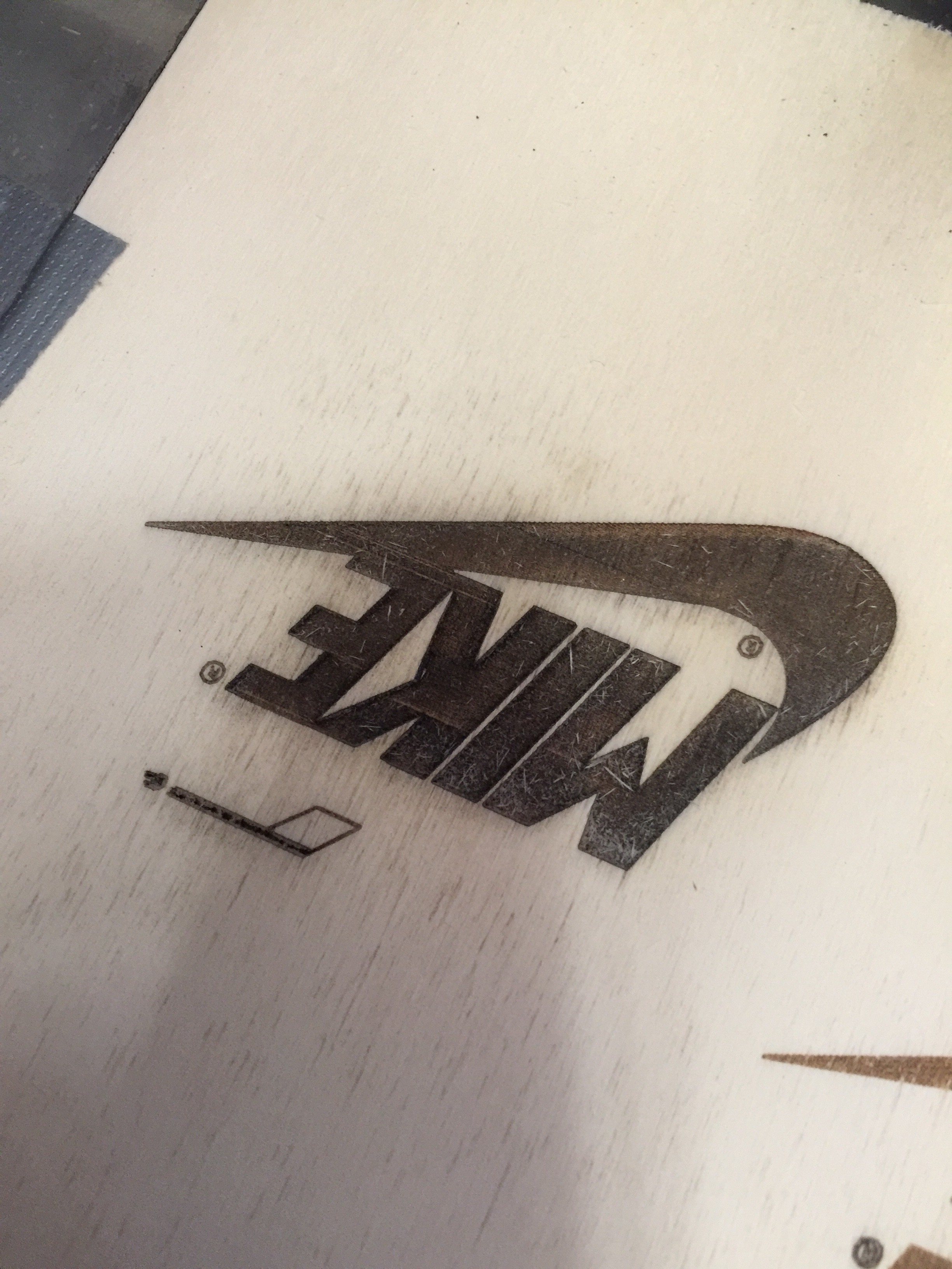

2% - 20mm/s and a clean lens… Much better!

Testing now with 0% and 20 mm/s, already seeing way less smoke staining around the engraving
Yeah haha its a bit silly it firing at 0% but if you go lower with the trickle power you risk vector engraves missing corners because smoothie adjusts the power to compensate speed change. I think the trickle power is set to 0.07 currently we been playing with it 0.05- 0.06 but 0.07 works for sure
