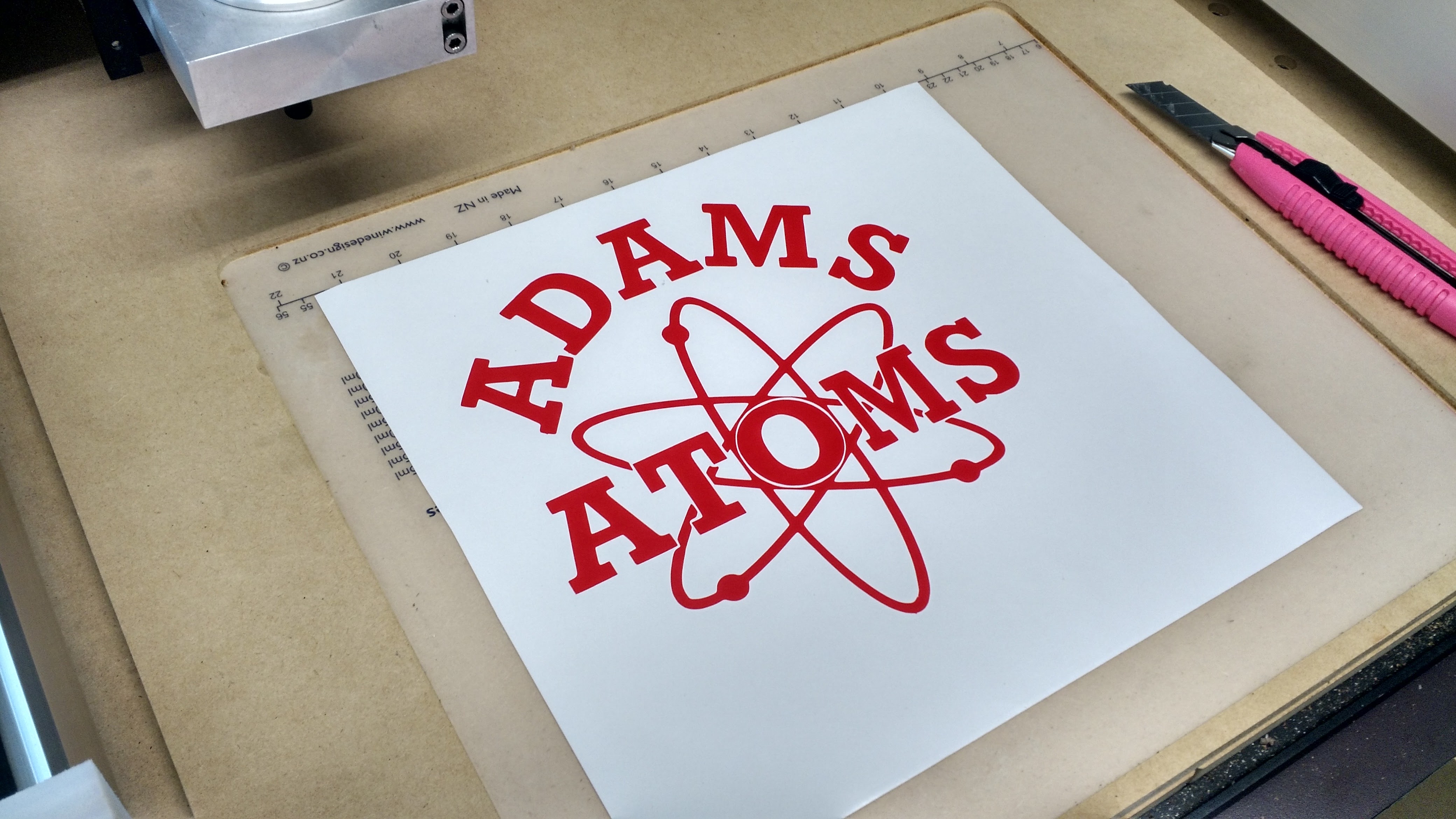

Got some new red vinyl for the drag knife…made something for my son’s wall. I love using Artcam express!
Looking good! What dragknife setup are you using? And how are you holding the vinyl down for the cut?

Hi there, not really other than mounting the spindle in the upper set of holes and use the lower for other things. I took my Makita to a local engineering shop with the stock mount and they made be a great ring adapter. As for everything else I just use the existing holes (lower) in the Z plate.
Andrew, how are you, if you are, accounting for the offset of the blade? Most vinyl cutter blades have a 0.25mm offset. Is there a setting that handles that automatically like my Roland Stika driver does?
