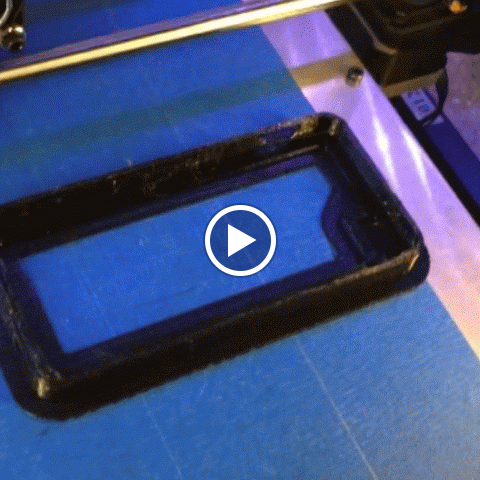

Got some #NinjaFlex today. This is so cool! This was my very first print with it.
It did fail at the last 7 layers though. Cause is unknown yet.
Settings
225*C
30mm/s
No retraction
That’s pretty much all I set.
Settings
225*C
30mm/s
No retraction
I found printing it with at 213C at 20mm with no retraction the ideal setting.
I’ll give that a shot thanks!
was this printed with a raft? try printing without - less clean up
It was, I love printing with a raft. As long as you get the raft settings correct, it makes it super easy to peel off and you get a perfect flat bottom.
But ya, printing NinjaFlex with a raft probably isn’t necessary.
si merveilleux
Does raft mean a thin first layer for sticking on the ground?
Yes, but it could be several layers. It’s designed to allow a printer to print on an uneven surface or to allow a larger contact area if the print has a bunch of small contact areas that might not stick very well. NinjaFlex really doesn’t need a raft as it sticks very well to most surfaces without any additional help.
