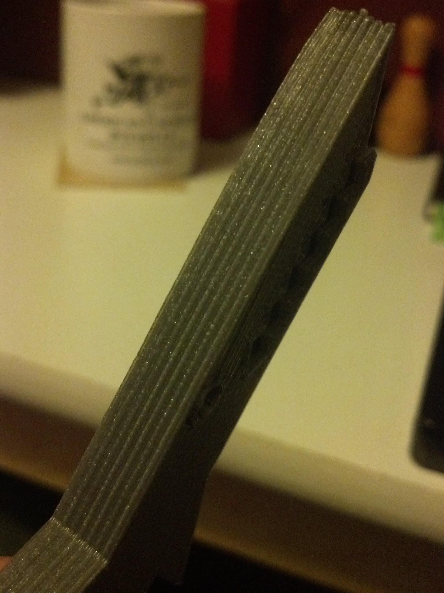

Got the J-Head mounted up and it’s just so cool to see my RepRap working again! Printed a shark and looked pretty good, but I have this interesting ribbing happening every few layers?
Are distance matching with pitch of lead screw? Using heatbed without pid ? Is there shift of layer or its spread means if there 1 ripple come out on one side is there any opposite side ripple that is inward?

It was a bent Z rod. What fixed it for me was Z wobble isolation - the type that allowed the Z rod to wander all over the place and not impose it’s deflections on the z carriage. http://www.thingiverse.com/thing:20147
Some people try to constrain the Z more and more to force the bend out, but that’s what flexes the printer and puts the ripples in the print.
Running the printer up and down as fast as it will go should show a slight wobble in the Z rod.

No heatbed (PLA), and I haven’t been able to discern a shift (although it’s a possibility, the method I’m using to hold the build surface to the carriage is shall we say, “temporary” :).
Interestingly it doesn’t seem to appear in the first few layers, but then after that the pattern is very regular. Bent z-rod is a possibility as well (I run my z-motors unfastened and they do wiggle a bit), so that might be something to look at as well.

Wobble / Bent Z rod issues can be worked around by not over constraining the rods: flexible tubing (vinyl , aquarium tubing) Z couplers help, and having no constraints on the bottom of the rods solved this kind of issue for me.
If you are running z motors unfastened and they wobble, then you have uneven layer height and this may be symptom.
I’ve gotta second the suggestion for vinyl tubing as Z threaded rod couplers and disconnecting any bottom constraints that you have. This is the setup that I’ve adjusted the machines at my lab to have, and they have perfect layer matchups.
Also, before doing that though, change your layer height to something more round. 0.20, 0.30, etc and see how that affects your prints.

@Mike_Creuzer finally got a chance to print those isolators (http://www.thingiverse.com/thing:20147) and get them mounted up. It made a world of difference! There’s still some ripple, but it’s nothing compared to what was there before.
I did drill out the x-ends a little to make room for the threaded rod to wander (and wander it does!). I’m also going to try some M6 rod in place of the M8 but I couldn’t find any locally so I’ll get to get some on order.
One problem I’ve noticed with those isolators though is that now I no longer have a nut forcing the x-carriage back down when z travels in the negative direction, and I notice that the bearing on one side hangs up sometimes and then all hell breaks loose
