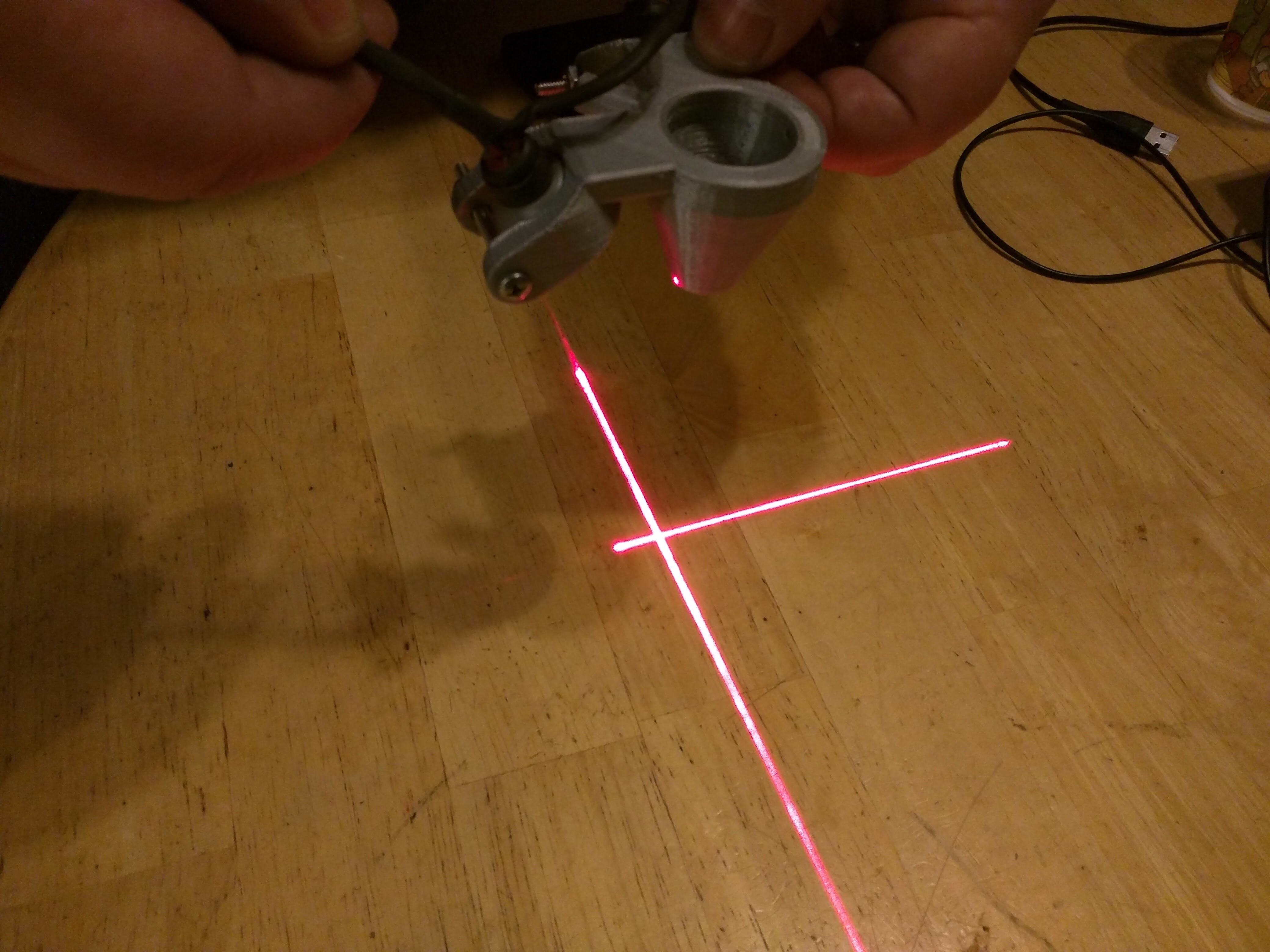

Got the line lasers installed.
Got the line lasers installed. Was a 12mm hole in the mounting spheres and my line modules were about 8.5mm dia. So I built up the diameter with multiple layers of heatshrink tubing then press fit the lasers. Worked good. Now no matter the height of the work piece, the Intersection is always in the beam path. Not sure if it will be useful but it’s been fun messing with it so far.

@Ariel_Yahni_UniKpty I got them from Amazon http://www.amazon.com/AixiZ-Module-Generator-ECONOMICAL-MODULE/dp/B00JJXI1BY?ie=UTF8&psc=1&redirect=true&ref_=oh_aui_detailpage_o00_s00
