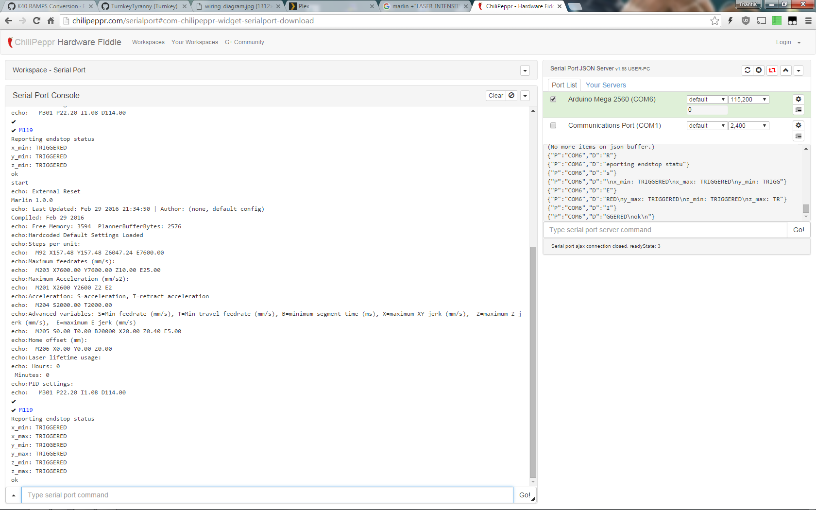

Got the RAMPS 1.2 up and running with new pins.h definitions.
Got the RAMPS 1.2 up and running with new pins.h definitions. Also had to disable LCD support – Is the LCD support in TurnKey Tyranny Marlin useful at all if you’re using LaserWeb? Chilipepper is kinda friggin’ useful. I’ve got a Raspberry Pi 3 on order that will be used for this machine. :smiley:
