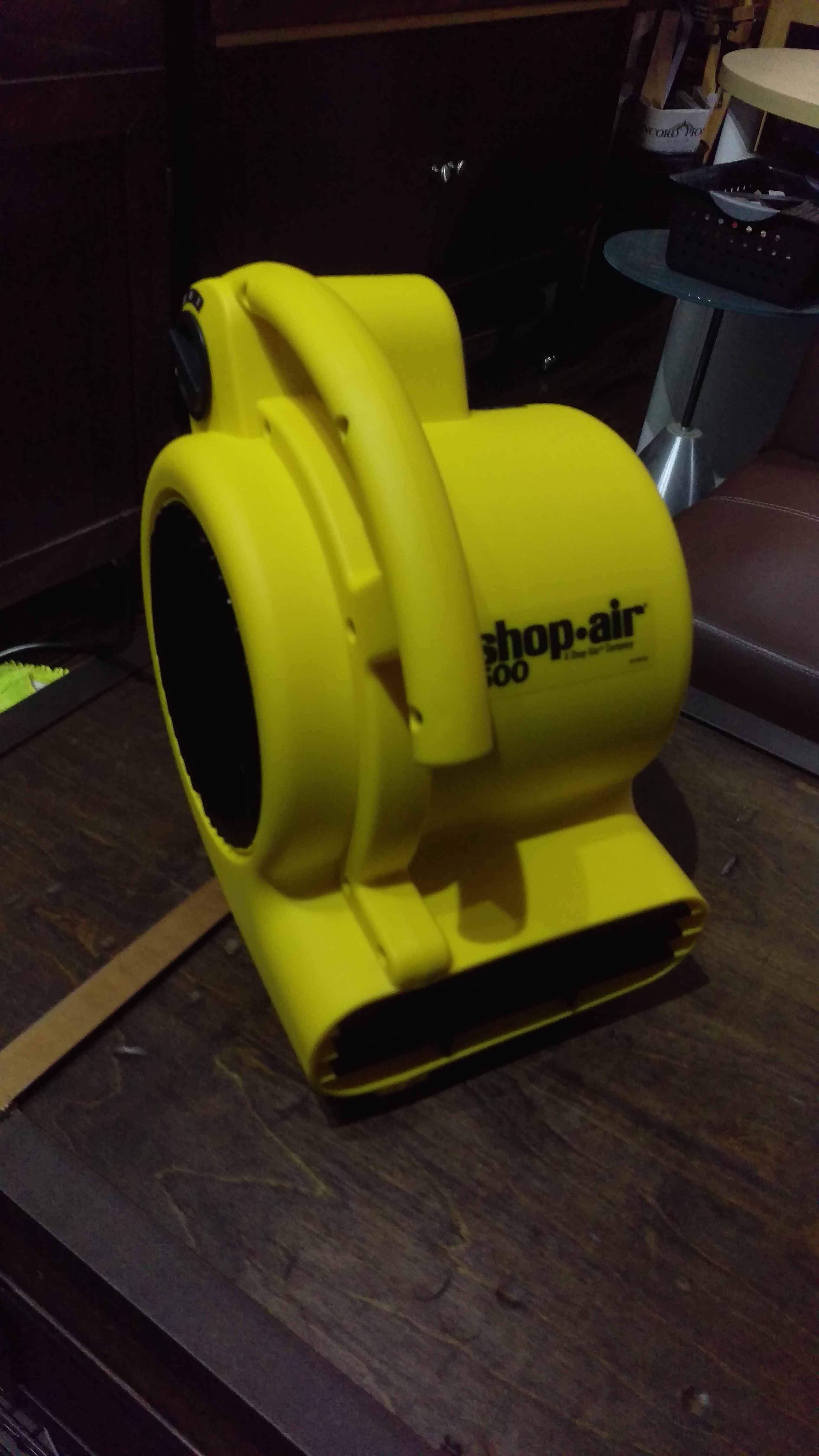

Got this 3 speed blower from amazon today for 50 bucks. Besides being a handy tool to have around, I thought it might make a nice upgraded blower.
That looks pretty decent. What’s it’s noise factor like? Loud or average?

I like the bilge blower idea. I’ll try that if this doesn’t work. The one I saw on Amazon was measured in a review at 5cfm+. Though this shop vac blower on high is supposed to be 500cfm so I’m hoping for way overkill to keep the compartment smoke free!

Any idea of how you’ll ‘plumb’ this to the K40? Doesn’t look like it has anyway to attach fittings, etc.
@Bob_Steinbeiser I cut a large hole in the bottom of the laser cutter and remounted the blower grille inside, clamping the blower sideways beneath the cutter. I have the cutter in a steamer trunk coffee table I made, so I also rearranged the rack below trunk part to make space.
