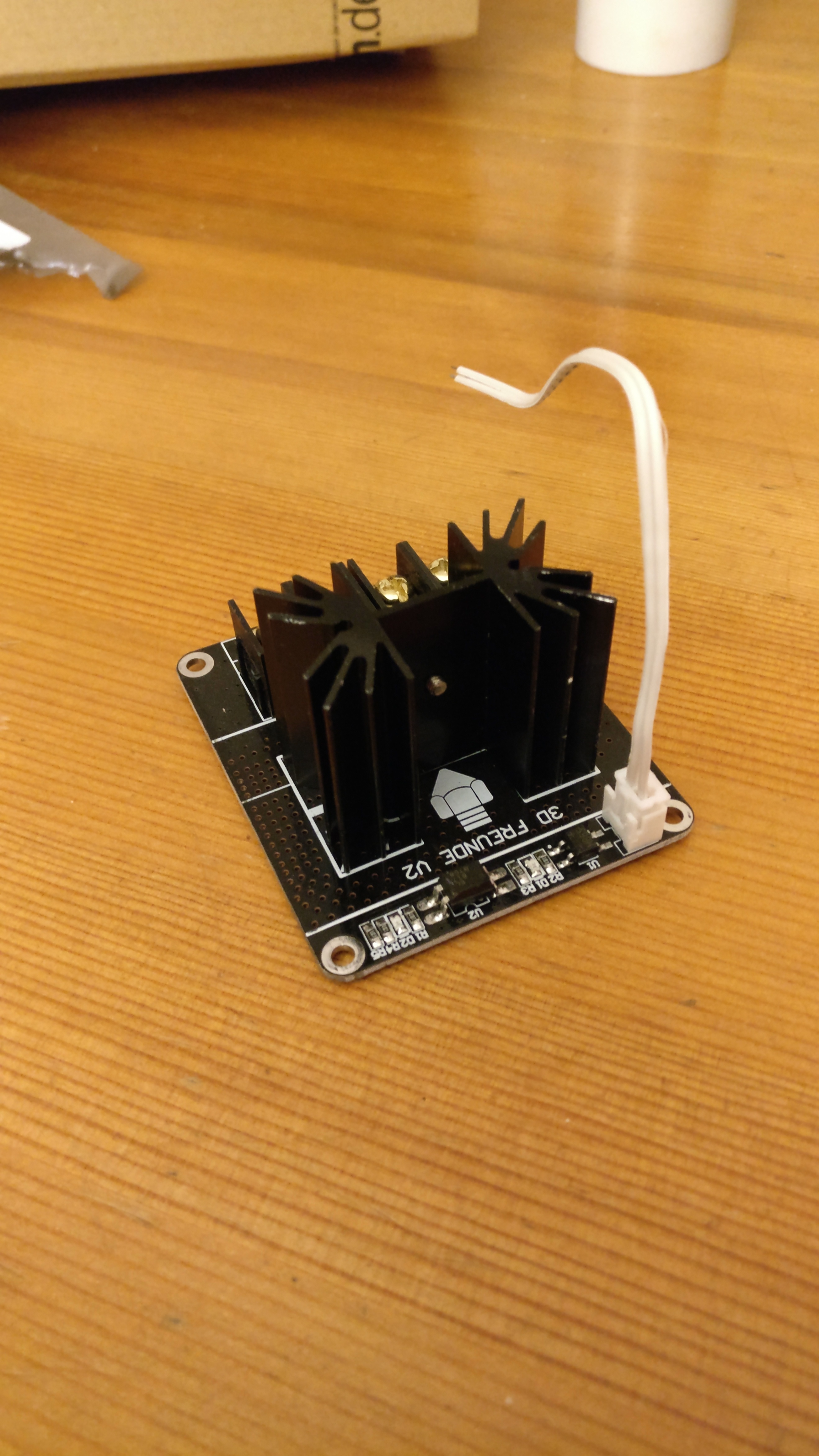

Got this delivered today. Pretty big boy there. Can't wait to use it.
Got this delivered today. Pretty big boy there. Can’t wait to use it. But I will have to wait a little bit longer.
They work really well. You can still use pid controlled settings unlike with a ssr.

this is just a better mosfet, not an SSR for my looks or? high power ;Mosfet…

@Este_ban_S yes this is a mosfet with a pretty huge heatsink.
