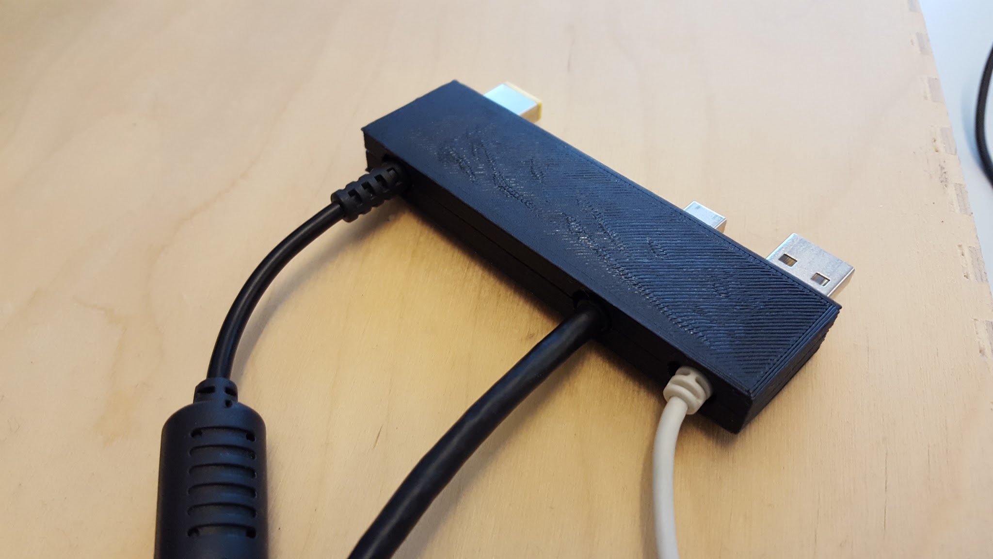

Got tired of plugging and unplugging the same three cables time and time again.Two-part
Got tired of plugging and unplugging the same three cables time and time again.Two-part snap-together holder with friction fit connector-specific cutouts for power, miniDP and USB makes them behave close to a single connector
The snap-together part of the design is simply a square-shaped registering shape. This worked better than the first try using circular shapes. Could be that tinkercad makes inner diameters at the corners of polygons rather than midpoints.

Are you kidding me? :slight_smile: I did the same thing for a friend’s mac, last week but we haven’t tested it yet! Heh! Here is a picture http://imgur.com/5b8LCVZ
Well done @Hannes_Lilliefeldt , the connectors seem to fit perfectly.
@Demetris_Stavrou good fit is easy to achieve with care, calipers and a calibrated printer.
