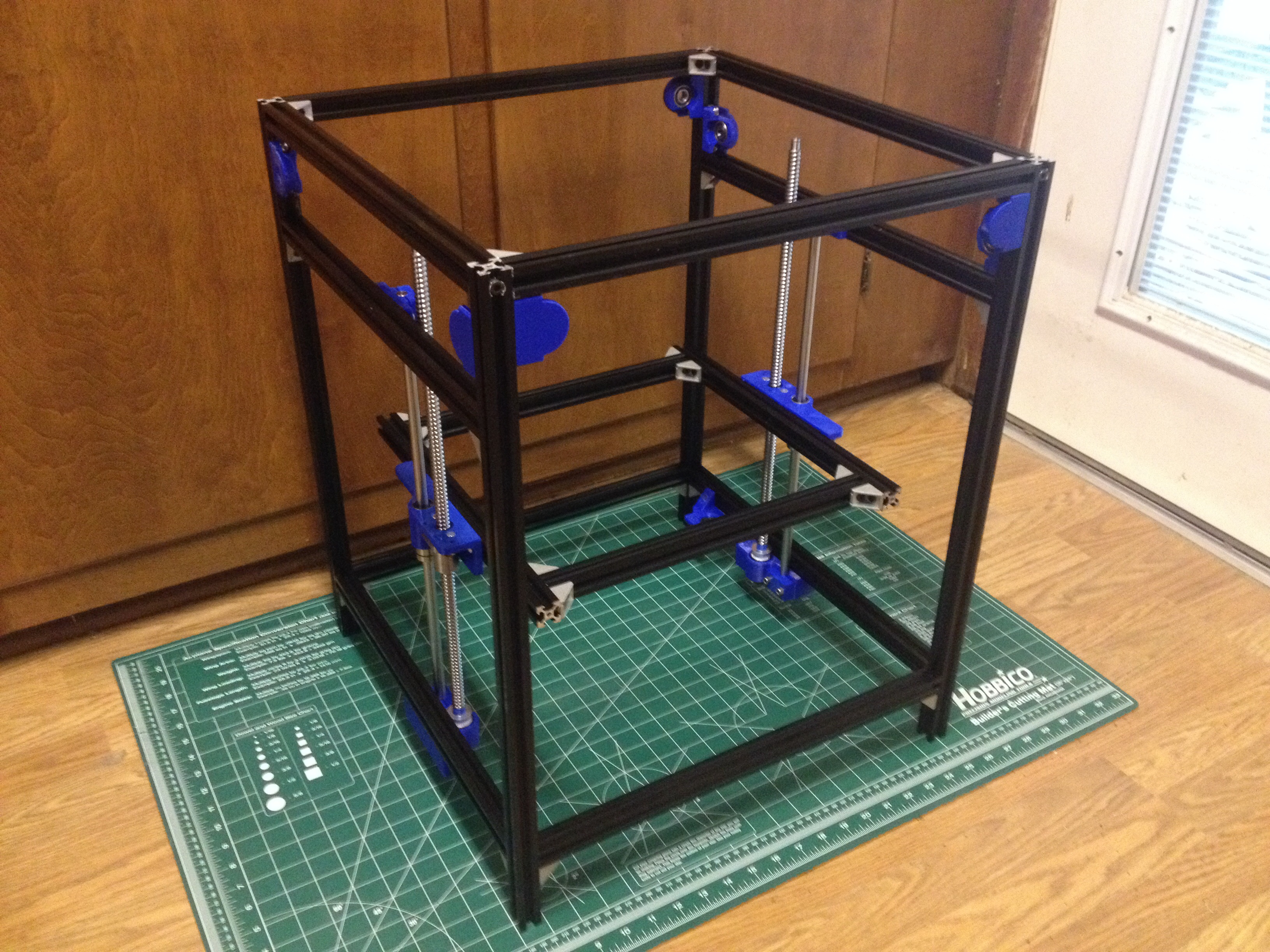

Got to do some test fitting today, everything went together quite nicely. This thing is a freakin tank! Can’t build the gantry until I get those ball screws trimmed up. Screwed up and ordered 500mm instead of 450mm.
I had blue ABS on hand, and 1000mm black 2020 aluminum extrusion was only $5.50 per stick when I ordered from SMW3D. Therefore, I ended up with a blue and black color scheme. I think it looks pretty good.

My new build is gonna be blue and black. Looks fantastic! I like the second crossbar on the bed assembly, but I don’t think it is all that necessary. What color are the floor and side panels going to be?
Yeah, the second cross bar isn’t necessary, this thing is solid as a rock. But I had a leftover ~600mm length of 2020 left after I had everything cut, so I put some of that to use.
Not sure yet what I’m going to do with the bottom and side panels. I have some clear acrylic sheet leftover from another project. I’ve been wondering how that would look…
I was considering clear acrylic too. I don’t want to make it black as I think that’ll be just too much black.
