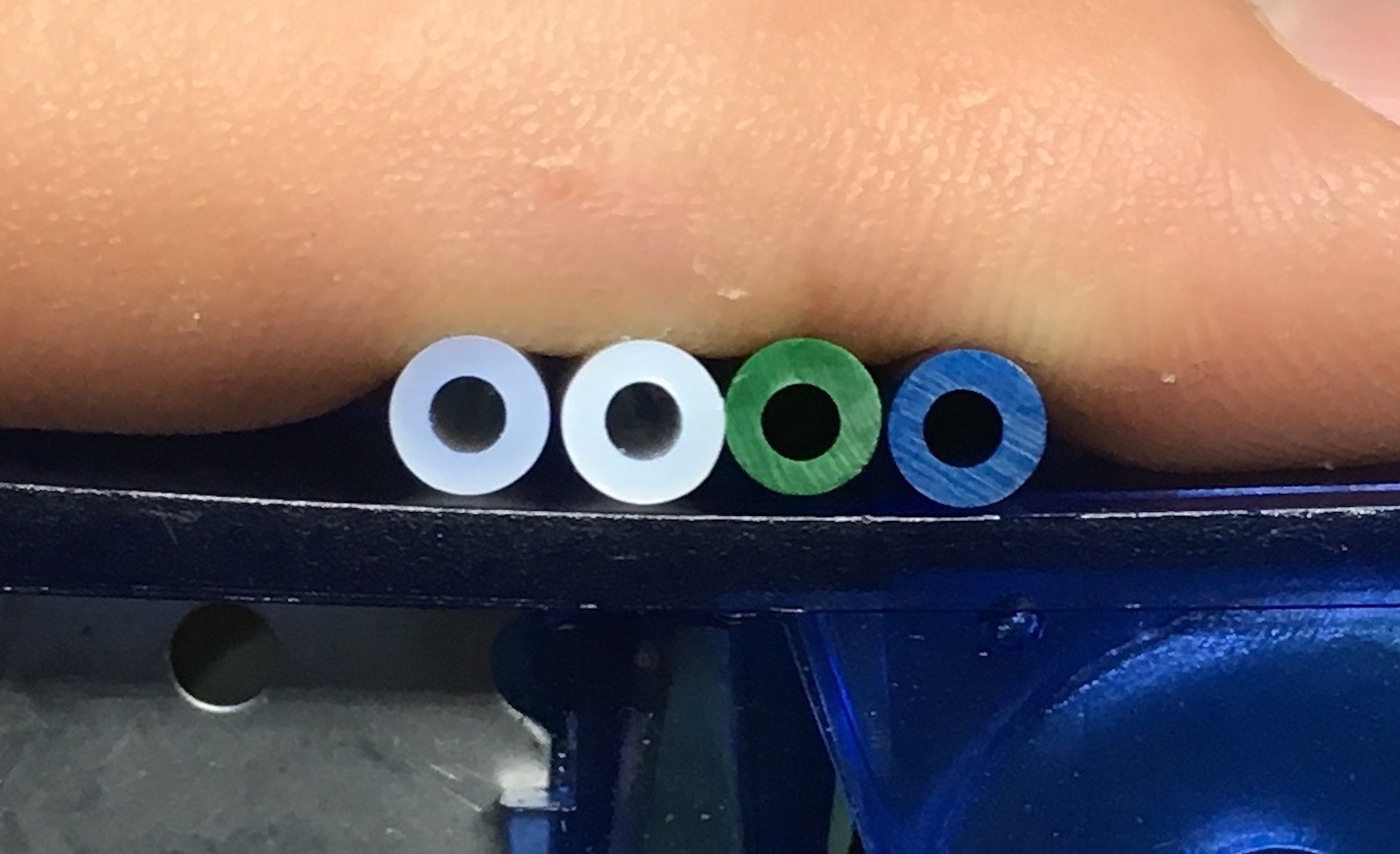

Got very different PTFE tubes today. Going to do some comparisons.
Got very different PTFE tubes today. Going to do some comparisons. First impression picture (please take a closer look):

The two on the right appear to have suspiciously poor manufacturing, as shown in the off-center bore.

The blue one also is slightly thicker or also off center. Or it’s oval.
@Daniel_Stauffer grey, green and blue are all 4mm more or less. The white one is 4.2mm on spot.
Did you measure the inner bore?
@Daniel_Stauffer As far as I can at this size. Grey and white are spot on 2mm. Green is a little bit bigger (dont know how much, yet). Blue is CLEARLY >2mm.
@Ryan_Carlyle Grey, white and green have equal friction. Blue has way higher friction. (all 1m long, same filament piece pulled through, 10 times each).
