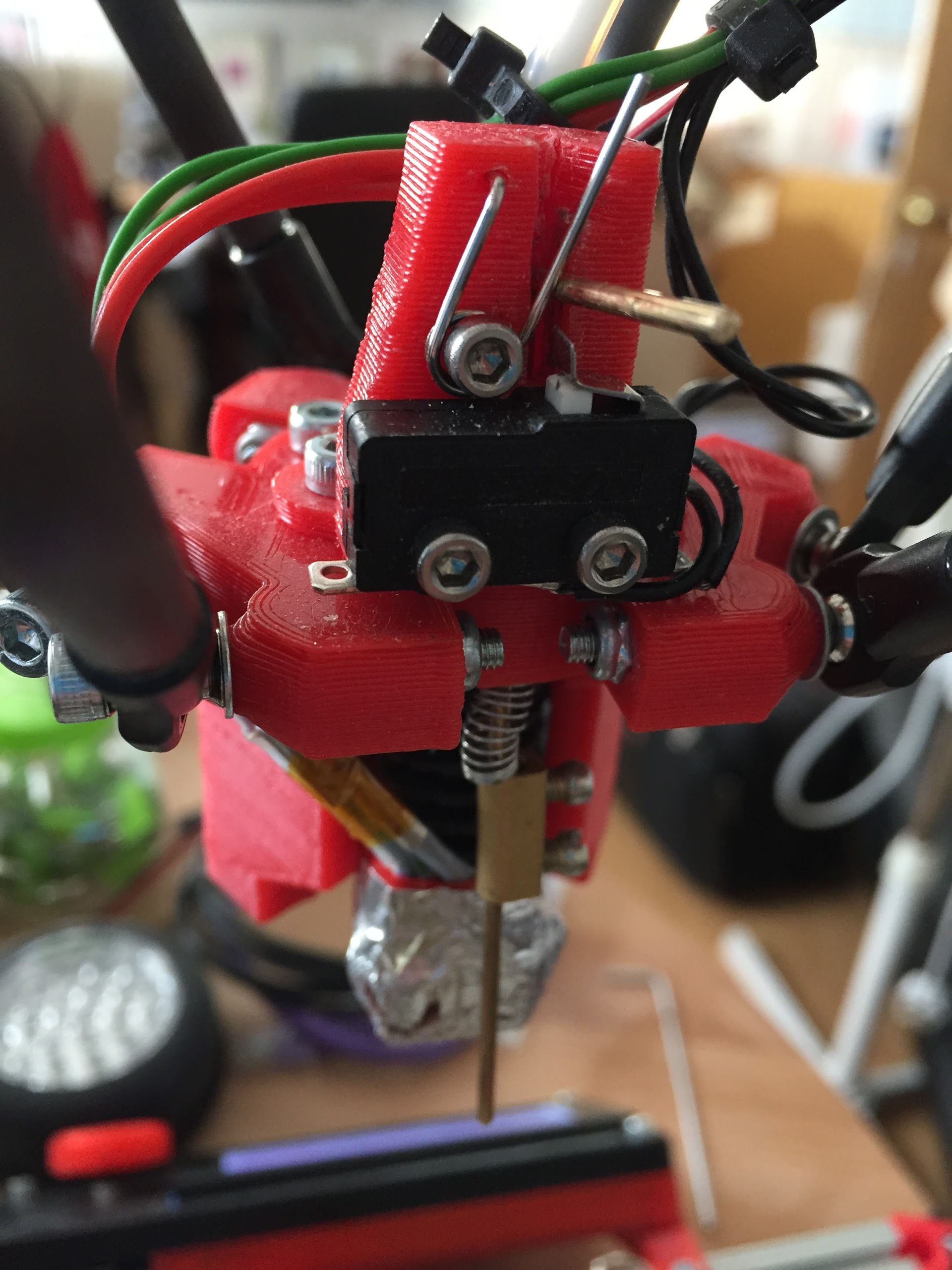

Gotcha! After going through a number of home and z-probe cycles I caught the
Gotcha! After going through a number of home and z-probe cycles I caught the culprit. A sticky z-probe pin. It only partially drops, so the switch is open when the sequence starts, moments later it drops all the way but by then it’s too late.

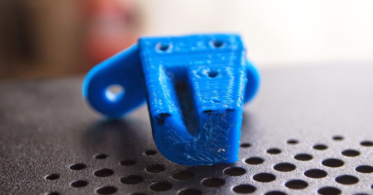

Here is a z-probe holder I used to replace the original one:
https://github.com/fredvj/Kossel-Mini/blob/master/Z-Probe/Z-Probe-holder.stl
You probably want to decrease the layer height when printing this part. Draft mode seems to be at least part of your problem.
Thanks Fred, I’ll give that a go. I didn’t print the original.

@Fred_vom_Jupiter printed @ 0.1 layer height and fitted, that’s working far better. Thanks again!
Glad to hear the part worked for you. I created a blog post with the story behind it:
