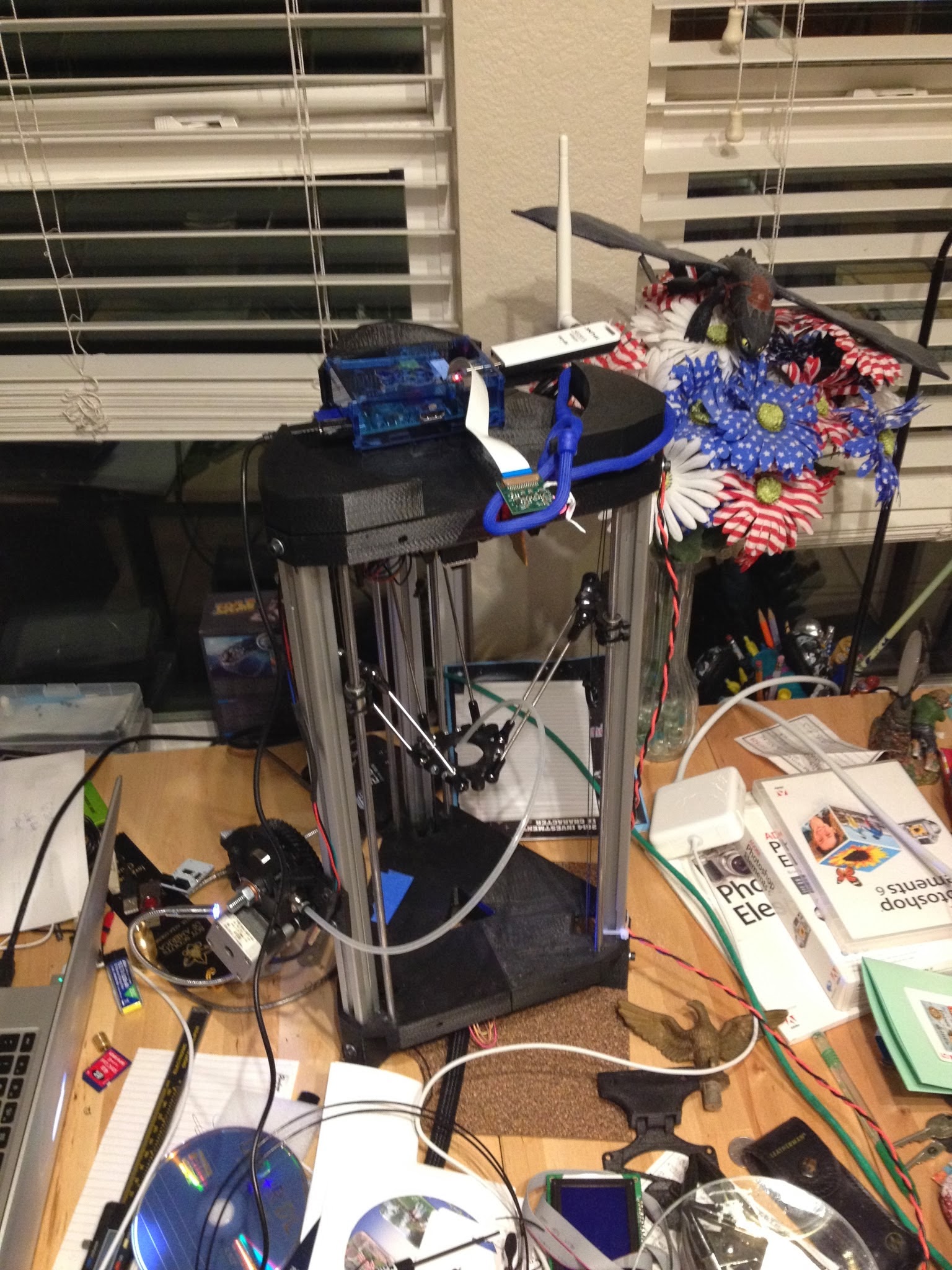

Gotta keep busy while the e3d's in customs...I just wish the RUMBA had a
Gotta keep busy while the e3d’s in customs…I just wish the RUMBA had a 5v USB power output. It’s got plenty of juice going into it from the ATX power supply, I just don’t want to get my ugly soldering skills going on a power feed for the Pi. Having a single power cord and a spool of filament being the only non printer things appeals to my inner OCD…and yeah, I’m ignoring the power supply. Sometime soon I’ll carve off the un-necessary loom…probably when I can print a plug for the hole it comes out of.
There is a 5v output pin on the RUMBA, at least you’d only have to worry about ugly crimping skills there.

Ok, so the 5V is for the pi, can you not get that from the ATX supply?
I can, but I’d rather have a single 12v +/- cable going into the printer…since I’m using a molex plug, I could conceivably use the 5v from it…still kinda wanna just run 5v off the rumba.
Octoprint seems to work pretty well, I had issues that may well have been my wireless base station, and the Pi gets overwhelmed when you try to do a phantom print and the Rumba is screaming “COLD EXTRUDER, EXTRUSION PREVENTED!!!”

How much power does the pi need?
If u can fit it u might be able to get a “car cigarette lighter USB charger” (search on eBay) and insert it into your base, connect 12v line to it in parallel with the machine and viola! U have a 5v USB port up to 2 amps (from memory)
I’m going to hold onto that idea actually :slight_smile:
I like that! The fact the sacrificial cable I bought for this aspect of the project included a car adapter makes it even better. (and it’s fused)
