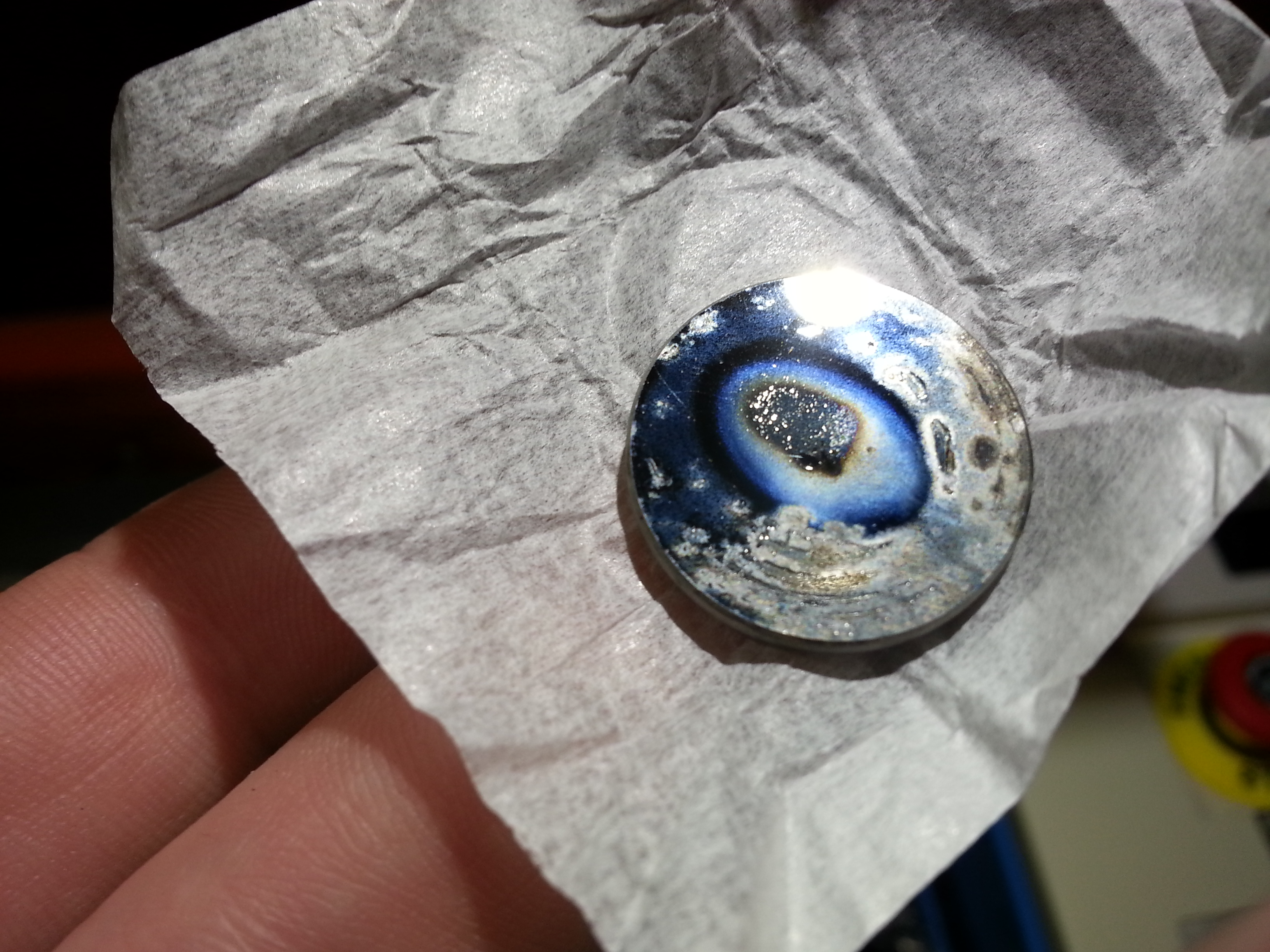

Gotta love stock mirrors. Only marginally better after cleaning.
Gotta love stock mirrors. Only marginally better after cleaning. Thankfully I had already purchased new optics from LO.
Just for the record, that’s even before firing my first test shot.
Wow. Amazing. Saltwater corrosion from shipping?
Fairly certain the dark spot in the middle and the halo around it was from something being on the mirror when they were testing at the factory and got cooked by the laser. The dark spot came off with cleaning, but the halo is still there. Not sure about the other stuff around the edges which only partially came off with cleaning.

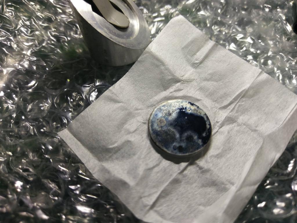

I checked the mirror inside laser head and found this also
the other 2 mirrors were spotless.
I used the machine for a week before checking this mirror. Is it possible I caused this or is this long-term corrosion that the seller obviously tried to hide inside the laser head out of sight?

Yeah the laser head mirror is the one I’m showing as well. The other 2 were in better condition. I looked at the mirrors under my microscope and it appears there is some reaction going on between head and the mirror blanks. From what I understand the coating on these mirrors is suppose to be gold. Not sure what the bulk of the mirror (the blank) is made of other than it appears to be some metal. The laser head appears to be aluminium but I’m not sure what grade. The laser head has the most contact area between the mirror and the mount as compared to the other two mounts so that appears to be why the laser head mirror shows the most damage. Could possibly be some galvanic corrosion between the head and the mirror blank as there is moisture present from the residual in the laser tube jacket.
@Alex_Krause Yeah the HCl vapor from the PVC would play hell with the aluminium. Lol I wonder if they tested the laser at the factory using a piece of PVC?
@Nedman ​ chlorine gas is nasty stuff I work in a PVC plant and we machine it… it off gasses in the lathes and corrodes all the metals inside after 6 months looks like our lathes are 15 yrs old
