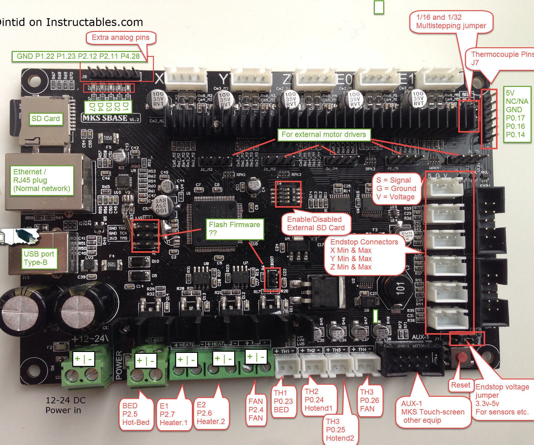

@Jeff_Lamb moment, you have the mks sbase correct? What is happend if you use a higher feedrate. If the motor screwing, then your max feedrate is too much. Also please check the temperature of ur steppers after 5min running time. They are too hot (you cant touch it or higher as 70° degrees) then ur current is to high (6 means 6 Ampere(!) … but one ampere is perfect.
Check ur microstep jumper on the board (8 is perfect, 16 is ok), here i found this text “All of the above are 1/32 multistepping. In order to use 1/32 you also need to set the correct jumper on your Controller. It is located almost at the upper right corner with 16|32 next to it. The pins are named J3.”

@Jeff_Lamb Did you set $140 and $141? The SBase board has the i2c chip. So you need to use the right firmware.
I have tested my K40 with a SBase board and I had to set X stepper to 0.4A ($140=0.4) and Y stepper to 0.6A ($141=0.6). My X-motor is smaller than Y. Do not set values over 1.5-1.7 or your drivers get to hot and switch off!
I did have them both set and y was working but x didn’t although it make a noise as though it was trying to move (not slipping teeth though). I increased the level and eventually it moved. Anything above 2 didn’t seem to make any difference and the drivers and steppers didn’t even get warm.
You hit the digipot’s max value.
