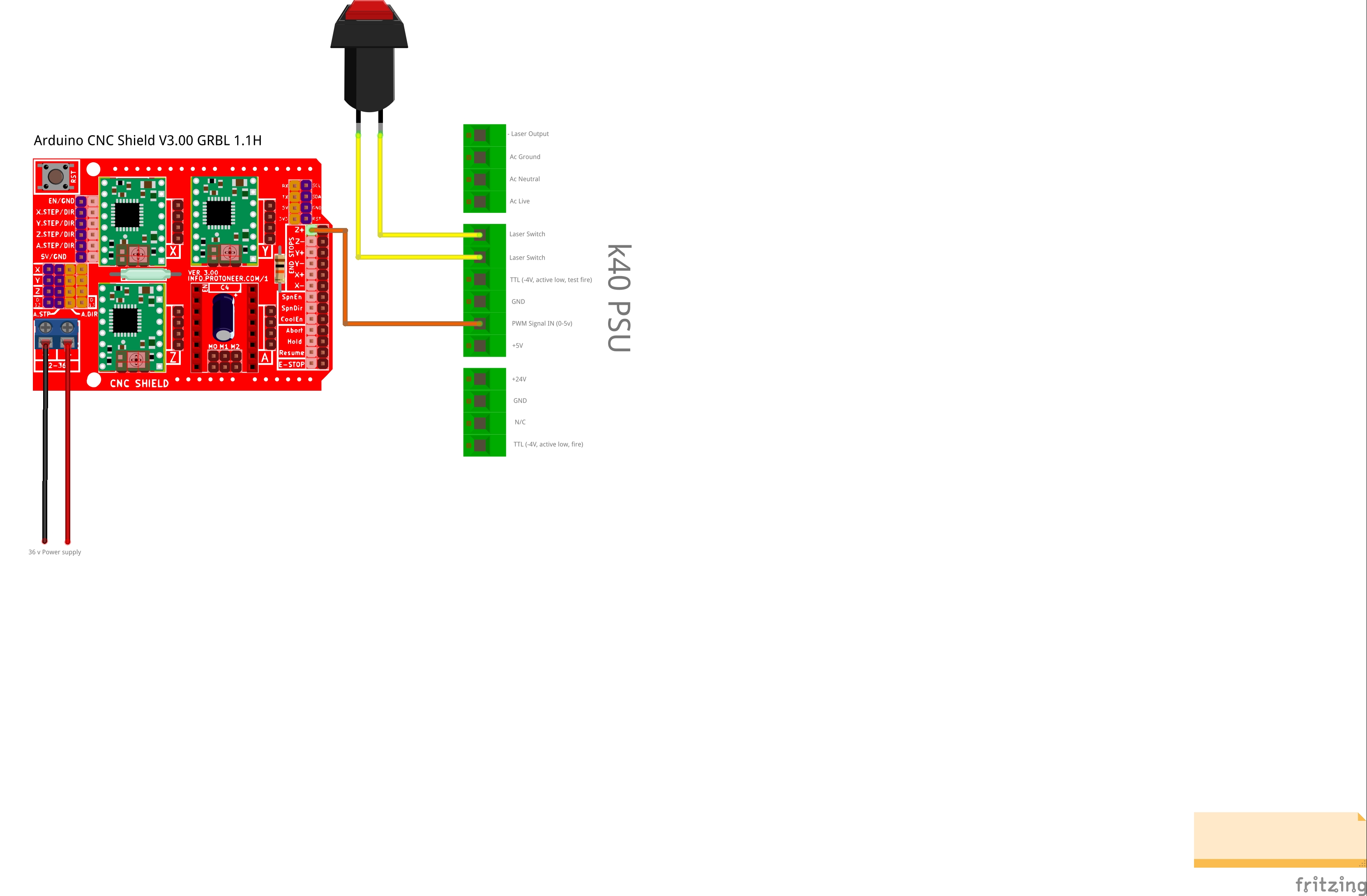

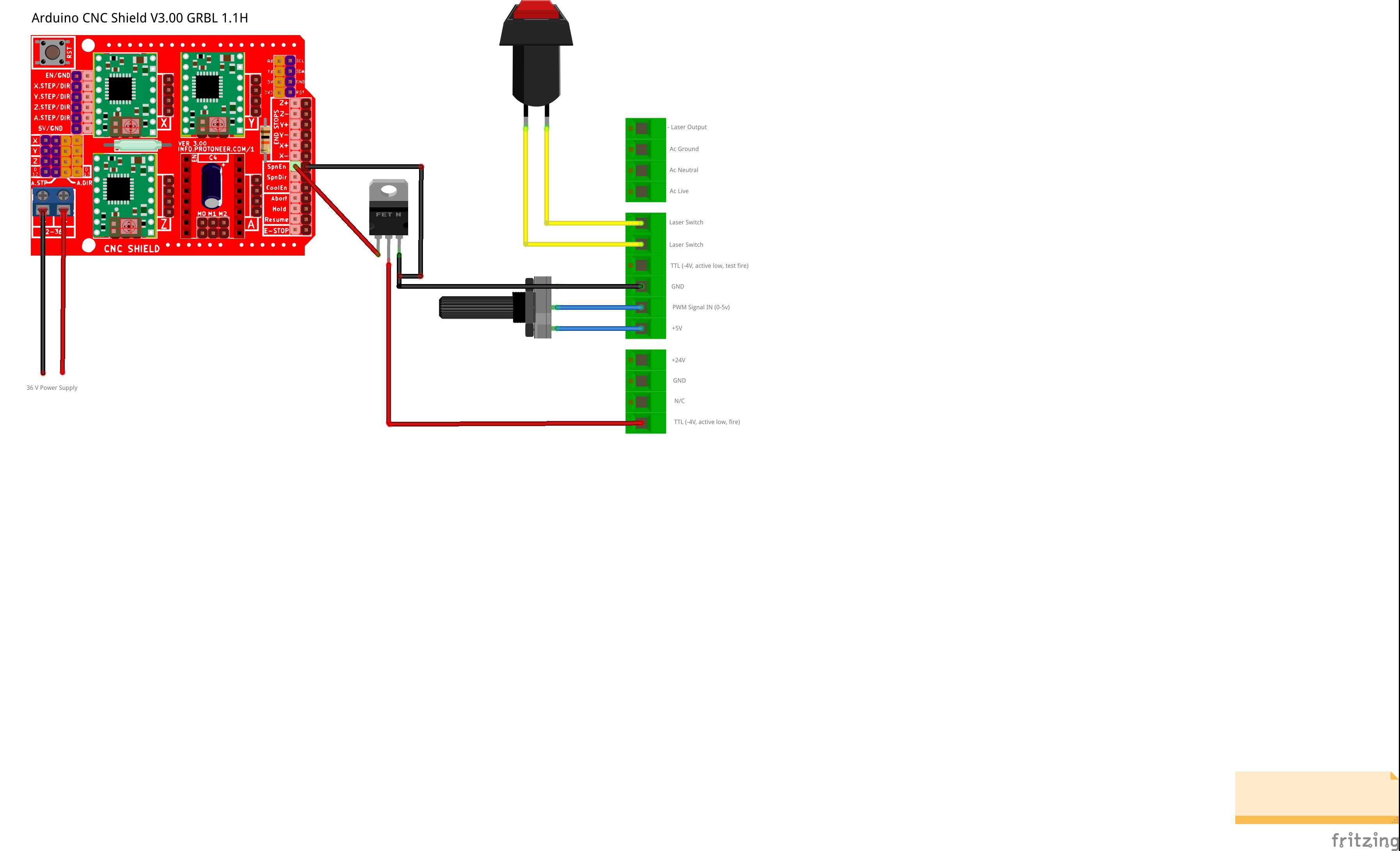

@cprezzi So not like this? Using the FET, does that control laser intensity by PWM or just on/off?
Normaly the IN pin is connected to a potentiometer to adjust the max current (= laser power) and the L pin is used for PWM (low active).
So I would connect the mosfet drain to the L pin without an additional pullup (because L is pulled up internally in the PSU).

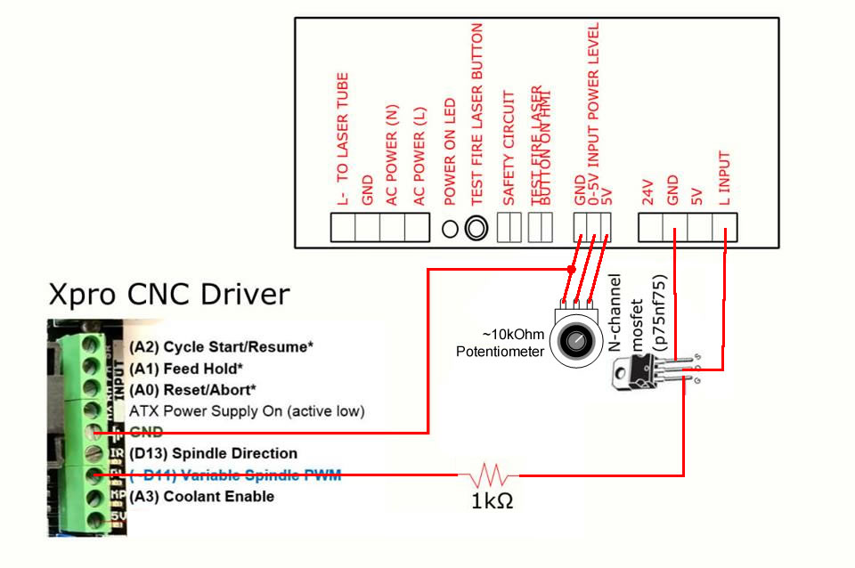

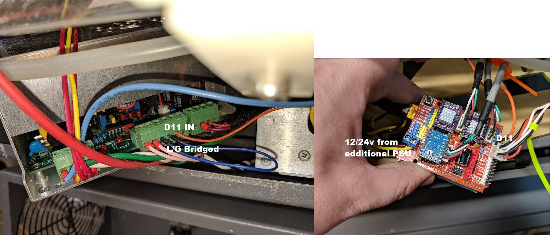

@cprezzi So like this or using the L on the center connector? A bud of mine is using the same controller without FET and has the L/G bridged (center connector) and has D11 to the 0-5v connection also on the center connector. His works fine and PWM is controlled by shield/Software BUT, he does have a certain way to power the board or he gets a prefire of laser which I am trying to avoid. That is why I wanted to add the FET to eliminate that. I am being told NUMEROUS ways to wire this up to a K40 and my head hurts… LOL
@cprezzi Here is my buds connections
@Custom_Creations Your schematics is close, but you don’t need the resistor and connection to 5V on the Xpro, because the Laser PSU has an internal pullup.
@cprezzi I do not have an xpro. Just example of connection :wink: So take off the resistor on the 5v connection and it will be correct or dont use the 5v and resistor at all??

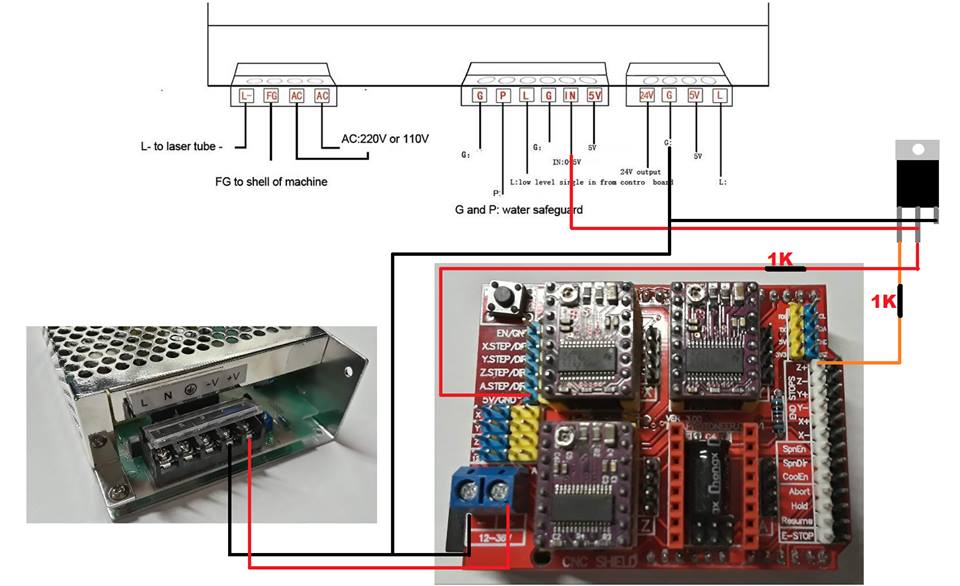

This also works with CNC-Shield:
The advantage of having a potentiometer is that you can adjust the maximum power with the pot and still use the whole PWM range of 0-100%. This way you don’t lose grayscale resolution.

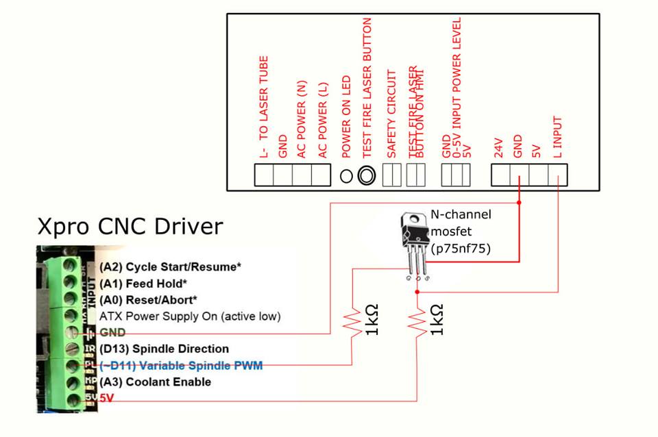

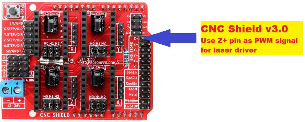

I modified my scheme by inserting an N-Channel Mosfet and the potentiometer. Is it correct now? I forgot to say that I am using Grbl 1.1F, so using SpnEn Pin is the greyscale preserved (or i need to use Z+ pin)?
That scheme looks fine.
If your CNC Shield is the older version V3.0, you need to use Z+ insted of SpnEn.
On CNC Shield V3.1 the pins was swapped, so you could use SpnEn(pwm) pin.
Hi @cprezzi, thank you very much. Do you recommend using a 1k ohm resistance between Z+ and mosfet? Also, I am unable to find a p75nf75 mosfet, is there an alternative?
