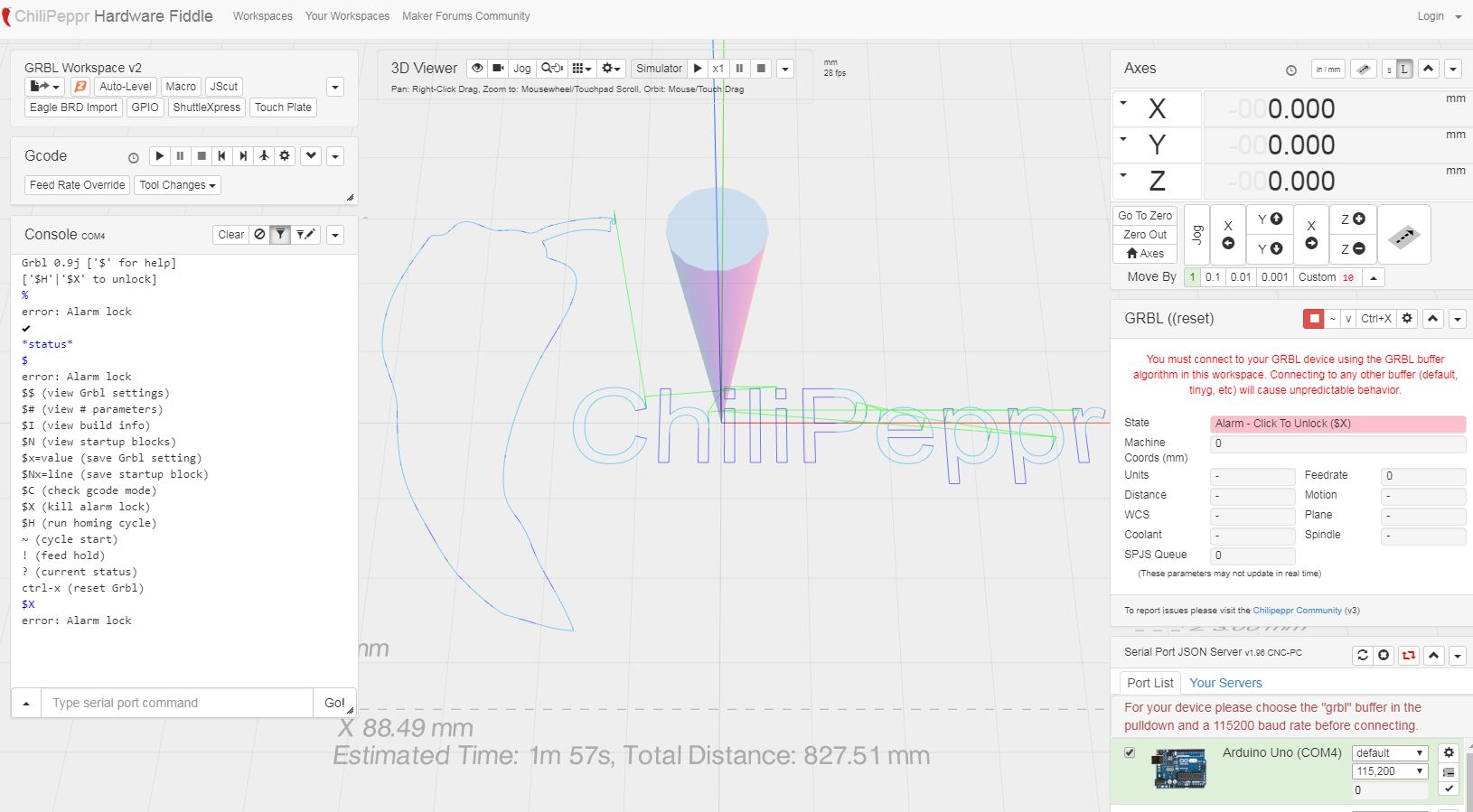

Been a few years since I used chilipeppr last. But I have a pcb project coming again, and would love to use the awesome features.
I downloaded the 64 json server for windows and run it. But I am unable to clear the alarm state, and so cant move my machine.
Any ideas?
error: Alarm lock
$X
Any commands get this response:
error: Expected command letter
error: Alarm lock error: Line overflow

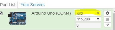

You need to connect using Grbl buffer, not default buffer like you have in your screenshots.
Took me a while to figure out what that meant, but I got it :slight_smile: Thanks!!
I’ll post a picture for anyone else as computer illiterate as me.
