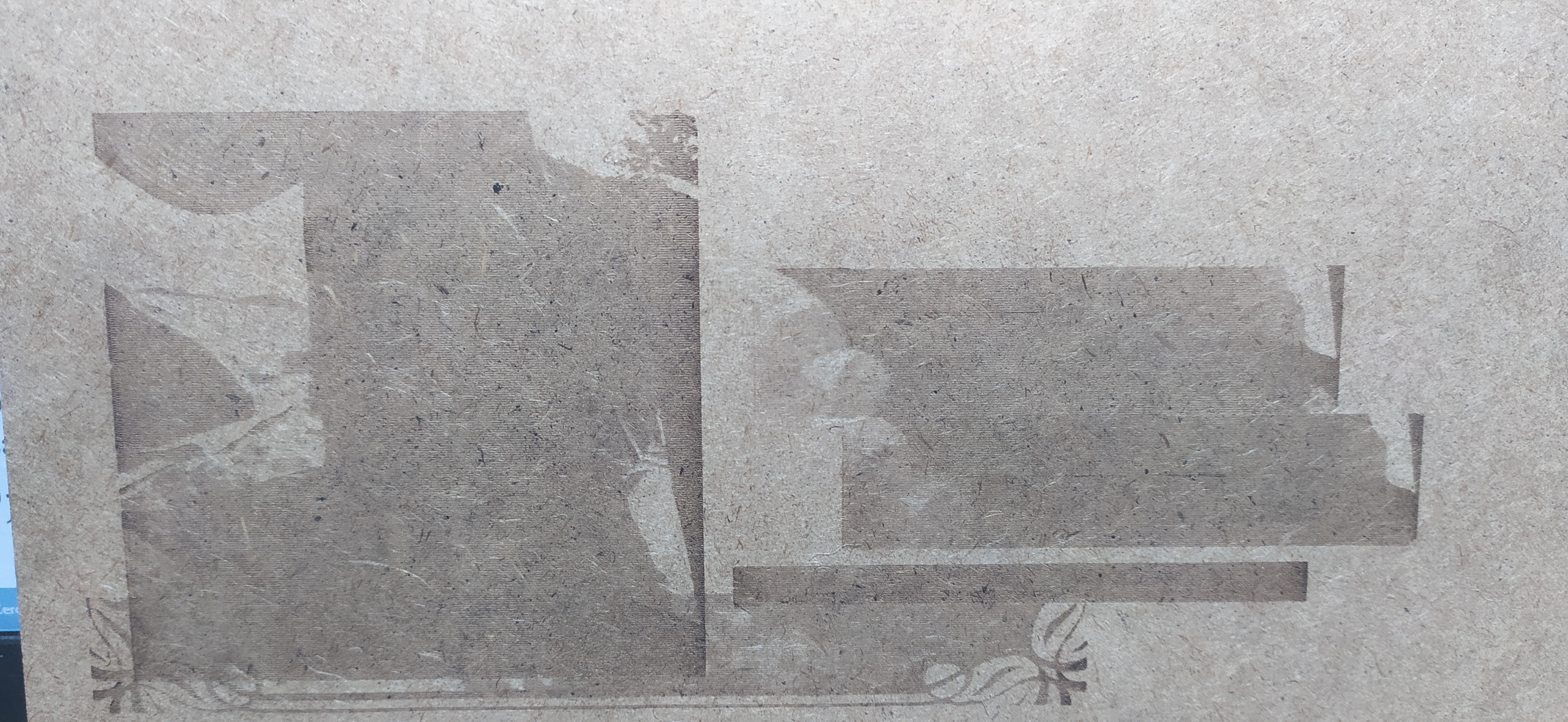

thanks for the answer this is the last attempt I made. 12000 mm / s
5% jpg 300dpi grayscale laser power via photoshop. So I try to change the dpi and change the tool size to 0.1mm? what speed and power?

the problem now is not so much the quality and that I can not make a grayscale … I tried to do as written on the LW documentation. I downloaded the calibration image which is this.

and I also did various focus tests. but I get horrible results.
I tried again to take a piece of photo with these settings.

From your pictures I would say that your laser is not focussed correctly (washed contours). Try to adjust the focus. This can have a big influence to the raster quality.
Also, lower the potentiometer, not the software power! If you lower the maximum power in LaserWeb, you reduce grayscale resolution (count of steps), if you do it with the pot, all the steps from 0 to 100% can be used.
