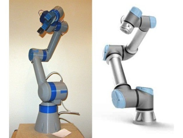

In the new version V3.46.0 a new 3D model of a 6-axis robot arm has been added.
It is the WE-R2.4, which was designed by Jeff Kerr at Thingiverse.
For those who are interested in details about the WE-R2.4, I recommend the very good 3-part documentation by John Lauer on YouTube
