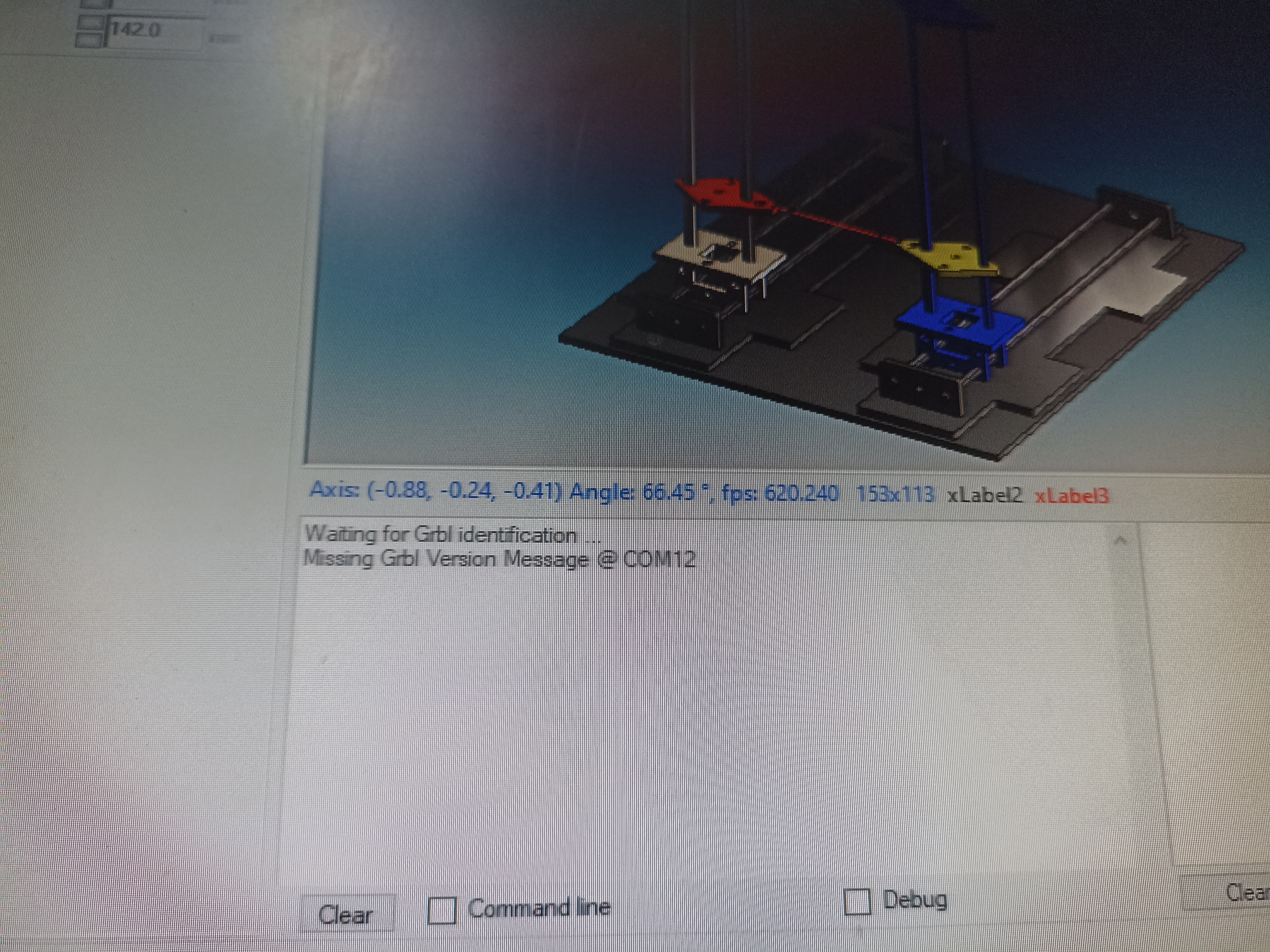

help, I can’t connect GrblGru. Always showing “Missing Grbl Version Message @ COM …”
I’m using grbl mega 5x, and connecting fine to grbl hotwire mega software.

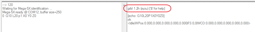

When establishing the USB connection I expect a normal ready message from Mega-5X. See pic below.

But the major problem is when load gcode file the software not drawing any patern/toolpath unlike in older version. you can see on the left is ver4.8.0 and right is ver5.1.2

note : I miss type on prev post. ver5.1.2 is on the left and ver4.8.0 on the right. but I think you already got it.
