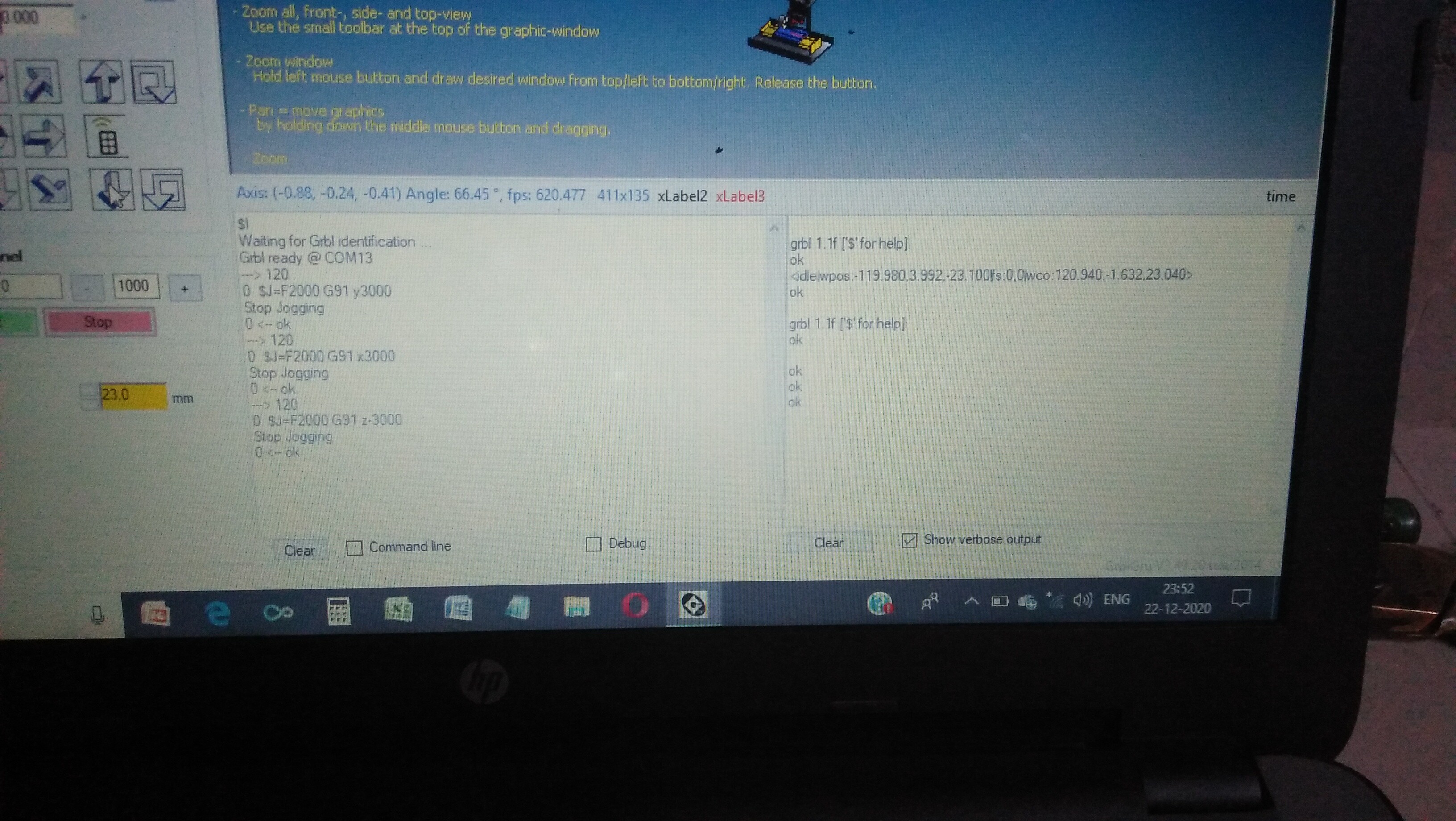

first i try to run ch340 cnc 3018 ,and i setting $$ all work status run on verbose output too everything work.
2nd i try run arduino mega 2560(driver ch341)+ramps 5 axis (install mega5x on arduino without xloader)
in grblgru x y z a b 5 axis i try jogging is work but status run on verbose output not show up.
am i make some mistake ,missing something?
need help please
thankyou verymuch

  • Does GRBL show up ready in the left controller window?
  • Is the 3D model moving ?
  • Are the motors moving ?
  • What version of Mega-5X have you flashed ?
Can you please make a screenshot of the two controller windows when the error occurs

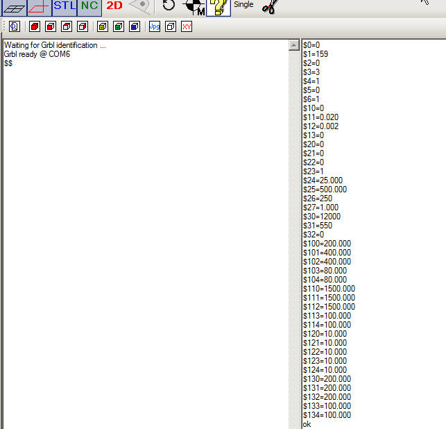

this is setting $$ grbl mega5x grblgru arduino2560+ramps 1.4
cmiiiw .need help to run correctly. thankyou

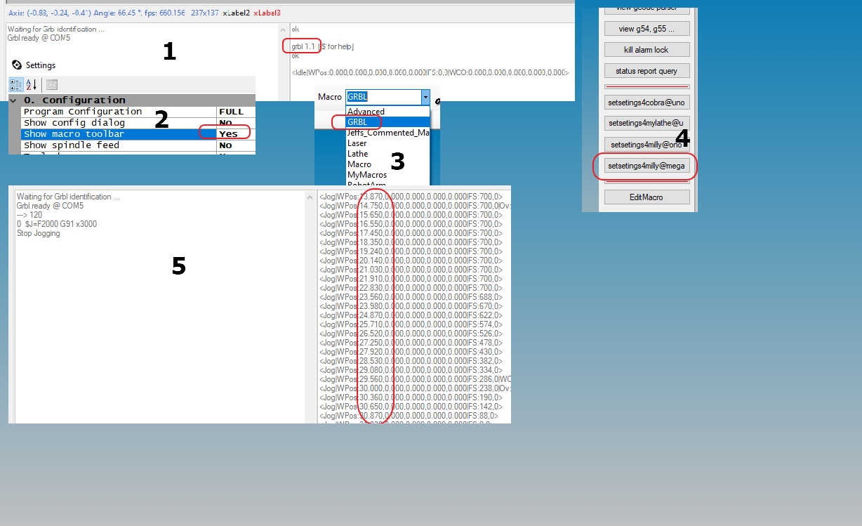

Please check this once. It should be grbl1.1L (see pic 1)
Then I suggest the following procedure:
  • Remove the ramp board
  • Connect only the Mega via USB to GrblGru
  • Switch on the macros in the settings (see pic 2)
  • Select the GRBL macro file (see pic 3)
  • Start the macro “SetSettings4milly@mega”; Attention ! this overwrites your settings, save them first (see pic 4)
  • Press the Jog Button X -> (see pic 5)
The X position must now change

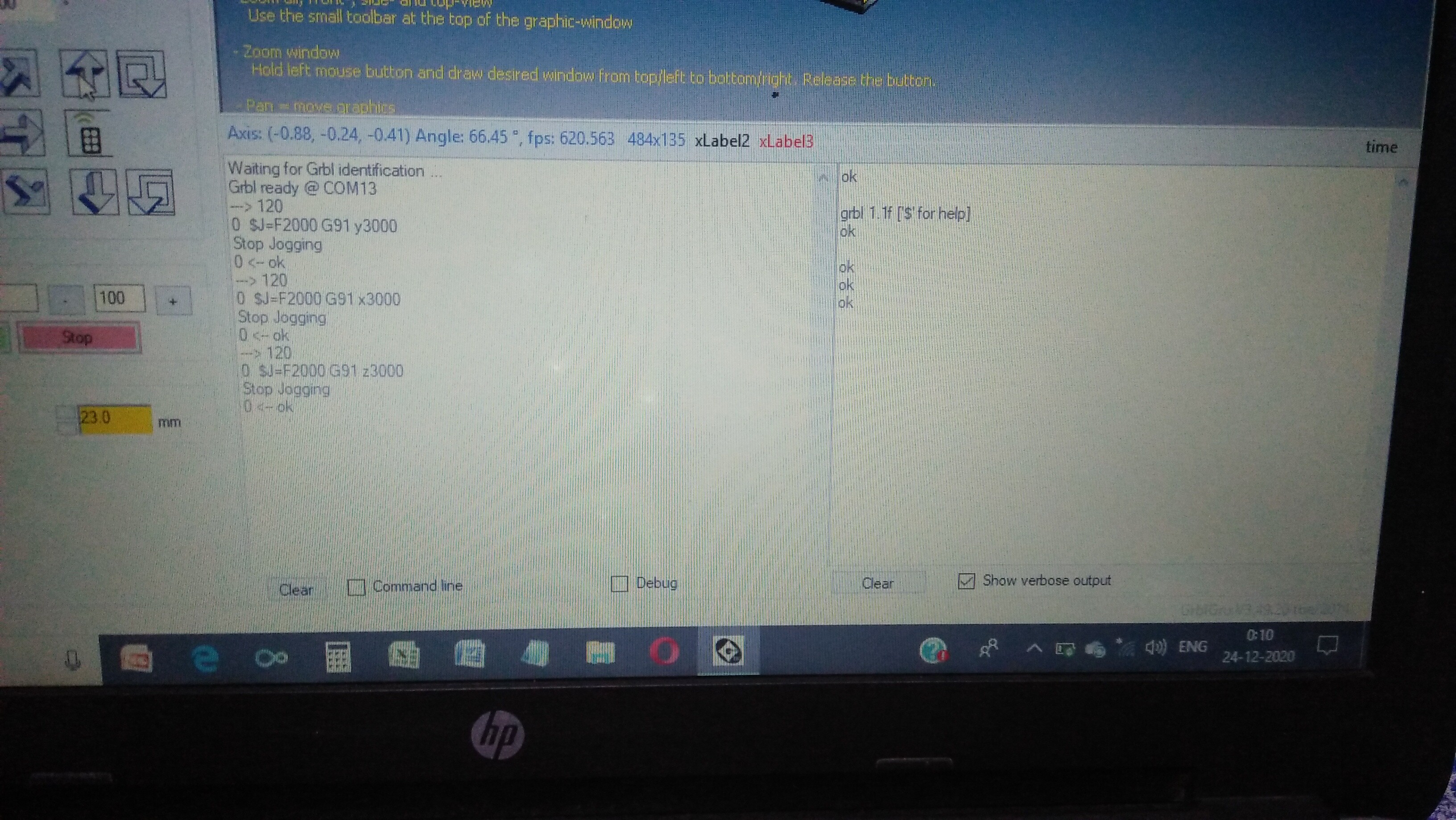

Hi I have same problem
After Macro file added nothing cheng stapper not moving yet !!
In right window show grbl 1.1 f
IMG20201222000537|690x388
The displayed error message indicates that you have used a command that GRBL does not know.
Mostly it is an unsupported M-command.
Supported commands can be found at: https://github.com/gnea/grbl/wiki/Grbl-v1.1-Commands
You can also suppress this error message in the settings if you are sure that the command is not important.

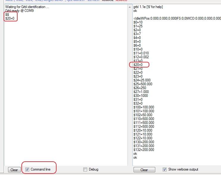

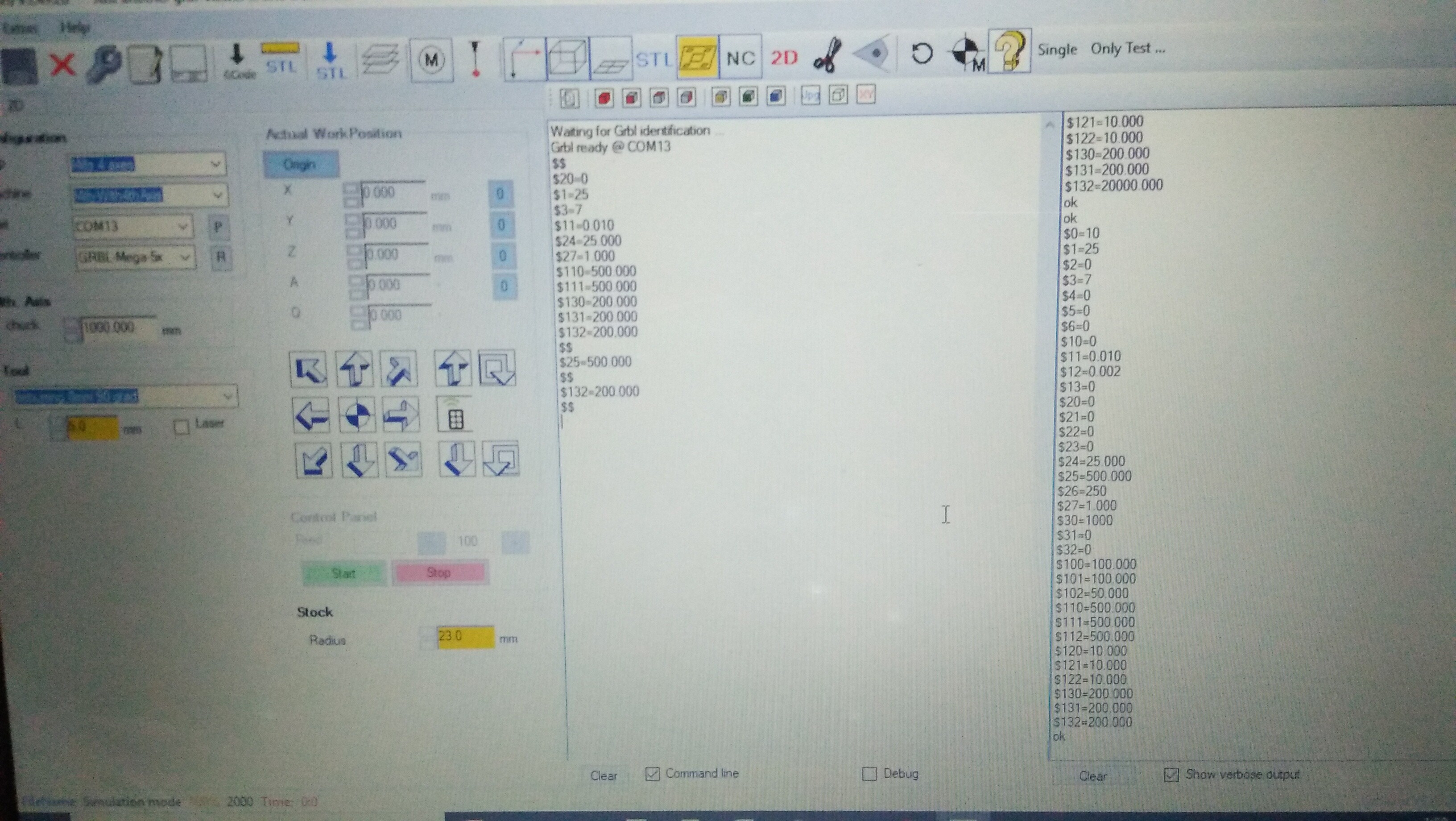

Can it be that you have “Soft limits” control active ? To disable it you have to set $20 to 0 in the GRBL settings.
Set the checkbox ‘Command line’ and enter ‘$$’ in the left window. Then your GRBL settings will be displayed in the right window. If the parameter $20=1, enter ‘$20=0’ in the left window.
Check if $20 is now 0 by entering ‘$$’ again.
Also compare the other settings with mine
Please take a screenshot of your Grbl settings and send it to me.
IM\G20201223015149|690x388now same settings as yours
Next what to do?
I saw in your last post that you tried to move the axes with the jog keys. That did not work. That’s why I suspected that it was the parameter $20. What was $20 before you entered $20= 0 ?
Anyway. Try again to move the axes with the jog keys and take a screenshot of the two windows below.
It’s all redy $20=0
Other perametar Cheng As I uploaded in last comment pic .

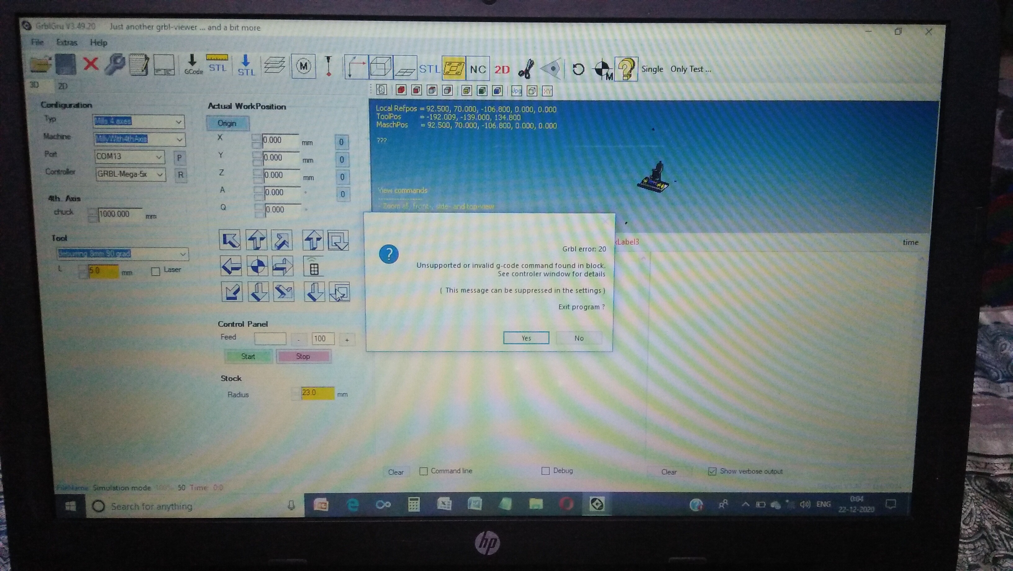

in first pic I pres jog key y, x, z
Second pi when I pres "a"rotry axis jog key and come dilog box of eror

If you use an Arduino Uno with Grbl, you have only 3 linear axes X,Y and Z. There is no A axis.
5 axes are provided by the Mega-5X operating system. This will only run on an Arduino Mega.In the operating system Mega-5X you can set which axes you want to have.

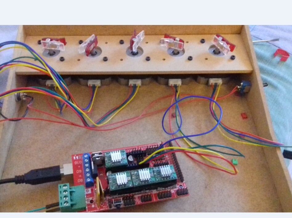

I have grbl mega 2560 and it’s ramps bord
And hex file is (grbl-mega_v1.1f.20170802.hex).
No one axes move
Pressd jog key and take screen shot and sand hear as you say
And I have no electronic expirince .
I just see your video on YouTube for mega 5x and arduino Mega I just ordered and start to make cnc
I need only x, z and a rotary axes
See your video and start all staps as you say

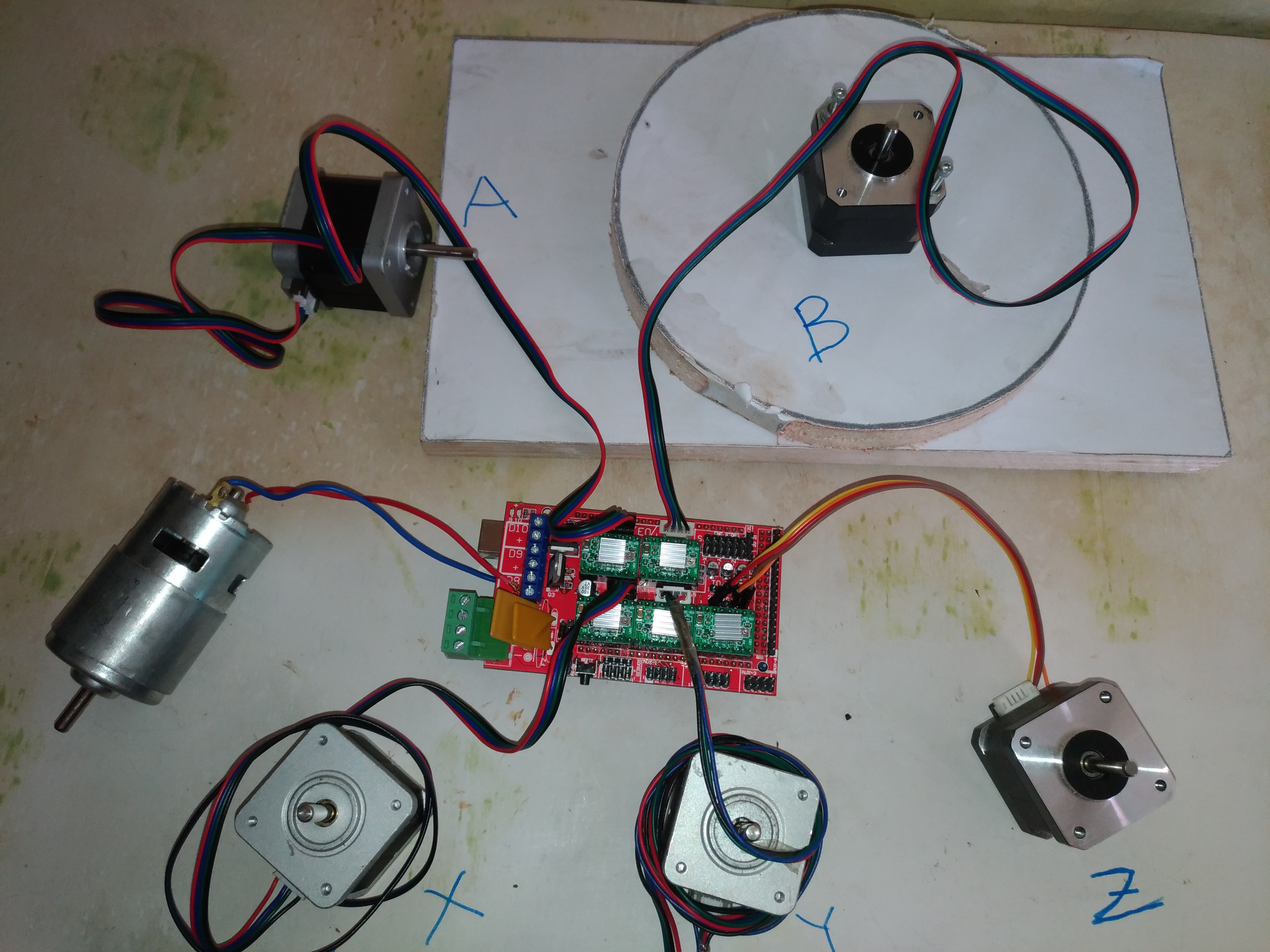

In hardware arduino mega, ramps bord, 12v dc power supply, Nema 17 stepper motor, 4988 stepper driver

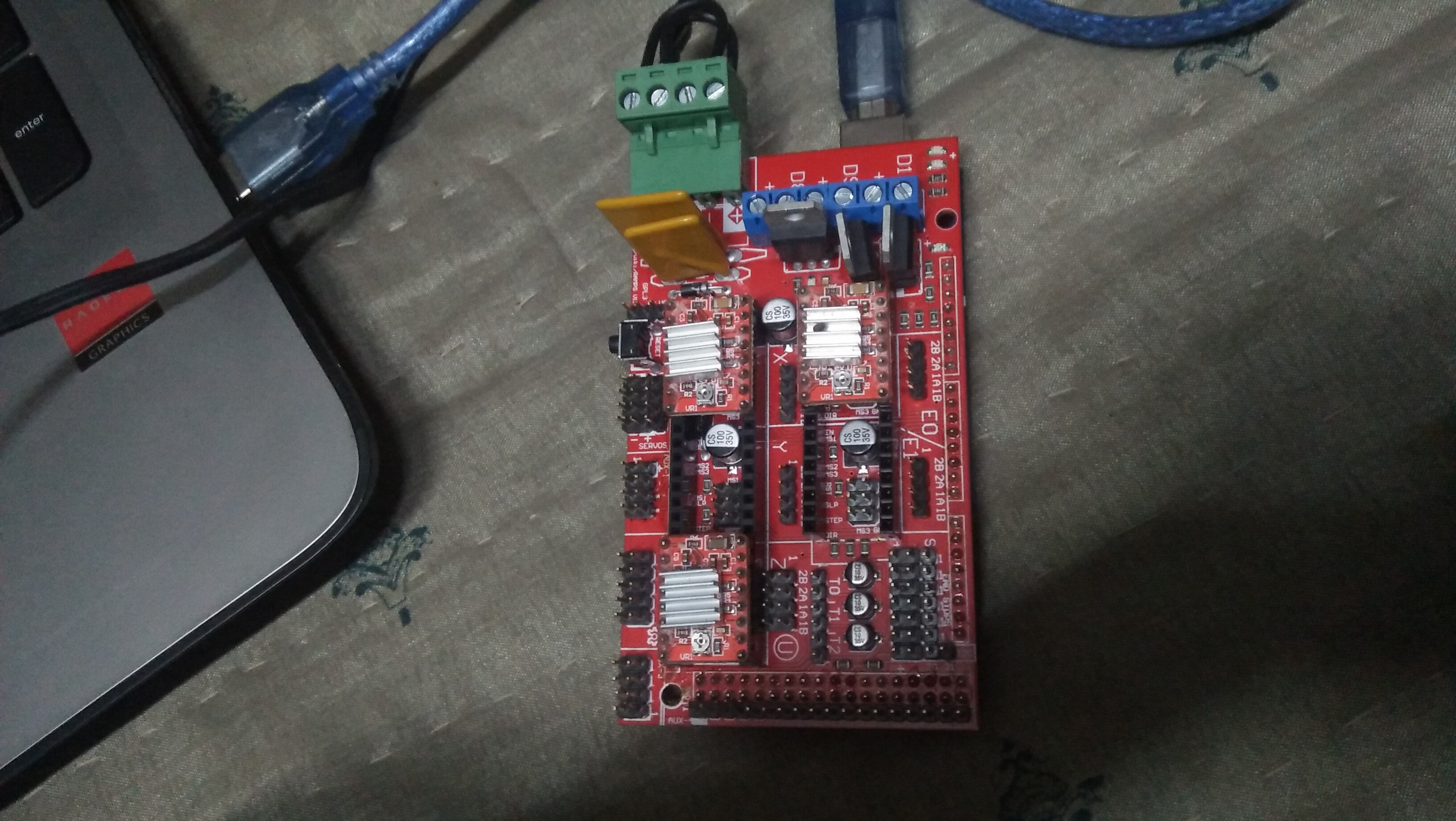

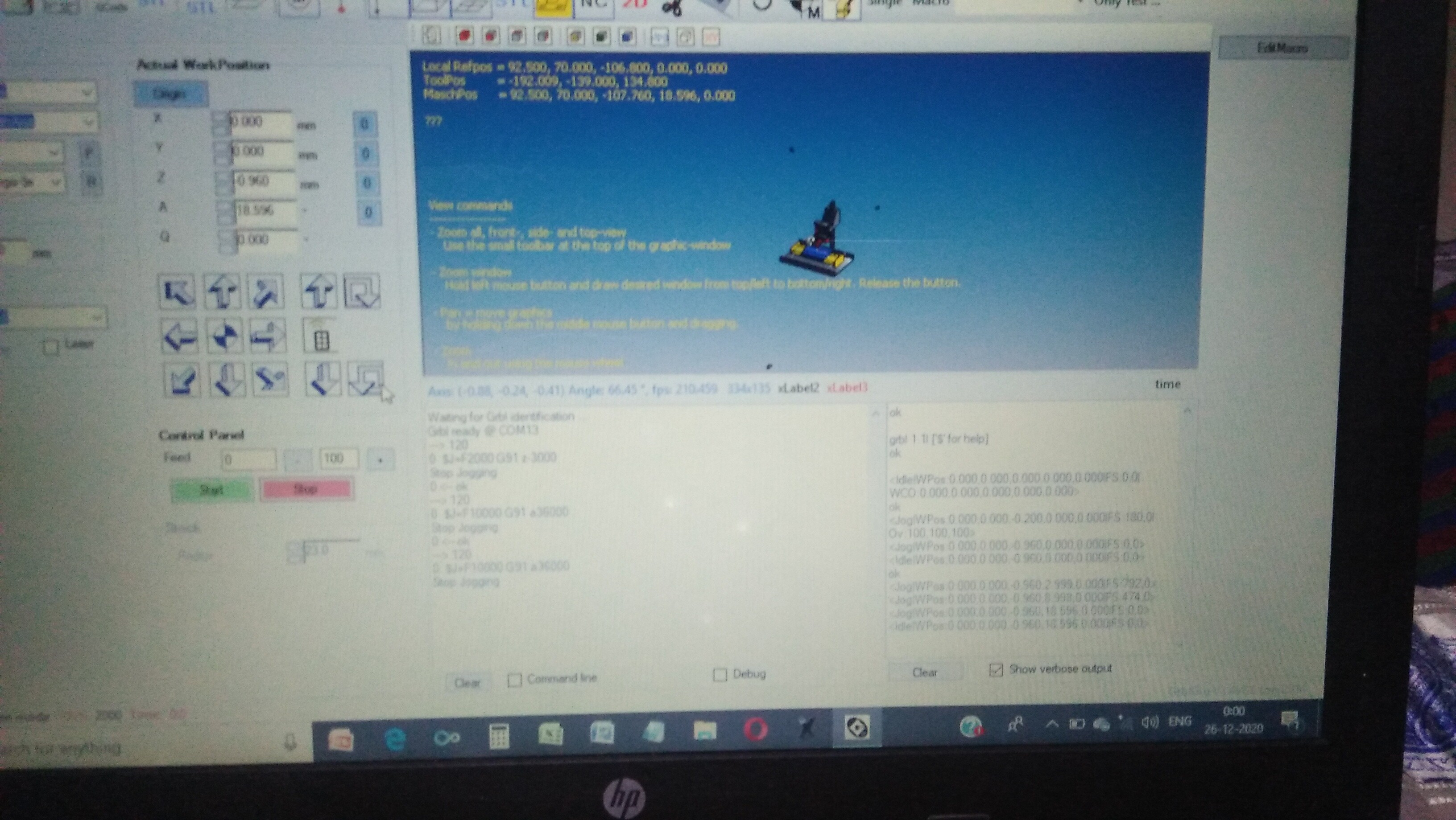

(Pic 1) but new issue is your hex file is installed in arduino then my ramps 1.4 bord aren’t show power so obviously can’t move stappers (pic 2)
Then I installed hex file which I have (grbl-mega_v1.1f.20170802.hex) and ramps bord show power and hear start old issues is controller can’t move sttapers (pic 3)
Now what am I doing :no_mouth:!
I can’t understand where is the problemIMG20201226000139|690x388
I removed sttaper when clicking pics
Believe me, I put everything together again just for you. The hex file I sent you is correct. I don’t know how you know that the ramps board has no power. On my board no leds light up either, but the motor runs fine.
On your last picture you can see that Mega-5X is sending axis positions in the right window. This must be the correct way !
Please flash my hex file again and check your motor connections. Use only one motor at first. Your power supply may not be able to supply enough current for more than one motor.
