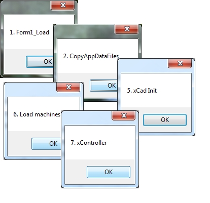

Then start the GrblGru shortcut by holding the SHIFT key !
GrblGru will start in test mode. A series of windows (See pics below) will appear where you always have to press return to continue. It is best to take screenshots of everything that is displayed.
pic 1
