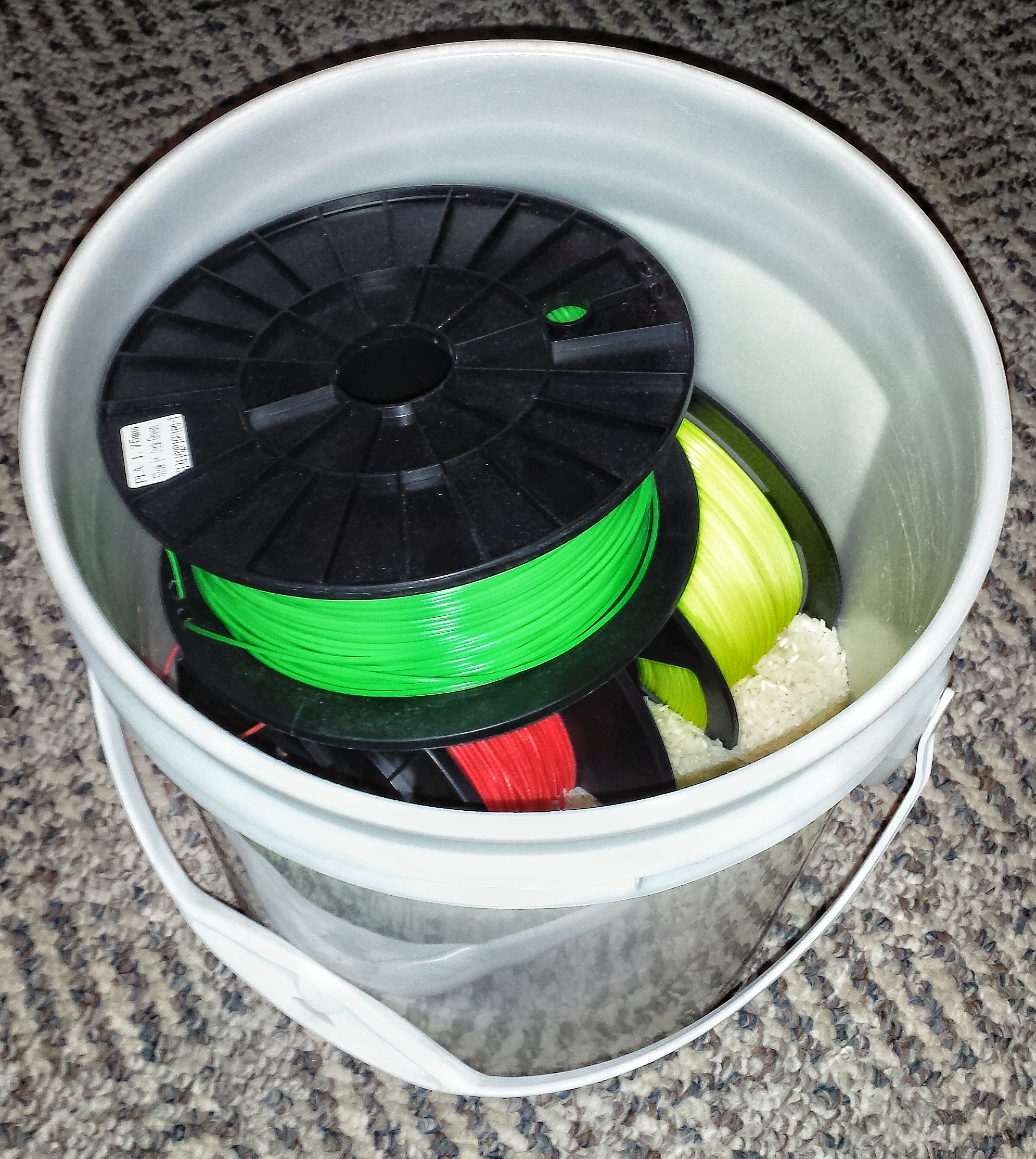

Great cost-effective (only $7) way to store plastic and protect it from absorbing moisture.
Great cost-effective (only $7) way to store plastic and protect it from absorbing moisture. Went to a local bulk foods store and bought a bucket with air-tight lid ($2) and some bulk rice ($5).
Ya they just have a rubber gasket. They originally were used for icing so they are water tight.
I use that but instead of rice, which can get super irritating when you take out filament, I use about 20 silica gel packs and 2 of those little dehumidifiers that you get for closets and stuff. Works really well!
I started out with a similar situation, the only problem is that you outgrow it very quickly.
Instead of rice you could use the Silica kitty litter, or packets as @James_Malenko suggested.
I just seal my spools in ziplock bags with a couple of silica packs in each.
Be sure to use an in line filament cleaner to wipe the rice dust off when printing.
@Tim_Youngblood1 I was thinking something similar for the rice. Put it into a sock like you mentioned or maybe put some cloth down between the rice and filament.

Could you give some examples of a bulk food store? I’d love to get an airtight bucket for $2

I bought my buckets at a small privately owned store. It is unlikely that a chain bulk food store would have buckets like that. Look for a smaller privately owned bakery/bulk or something like that.

Was just thinking about it, but the spools don’t seem to take up the full diameter of the bucket. What about using two buckets instead? The perimeter of the outer one filled with rice or some other desiccant, while the inner bucket stores your spools safely away from contamination.
