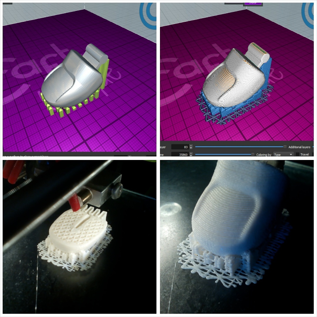

Great feature of the free Craftware slicer from CraftUnique .
Great feature of the free Craftware slicer from @CraftUnique . Editable support, easily removable from this #Filaflex thumb after printing. You can add, remove, resize those pillars before slicing, even place them on angles like tree branches.
@Mark_Rehorst It’s strangely named extrusion width.
@Ashley_Webster It’s the extrusion % under toolpath settings. If you have a nozzle that is 0.4 and you want an extrusion width of 0.8 then set the % to 200.
