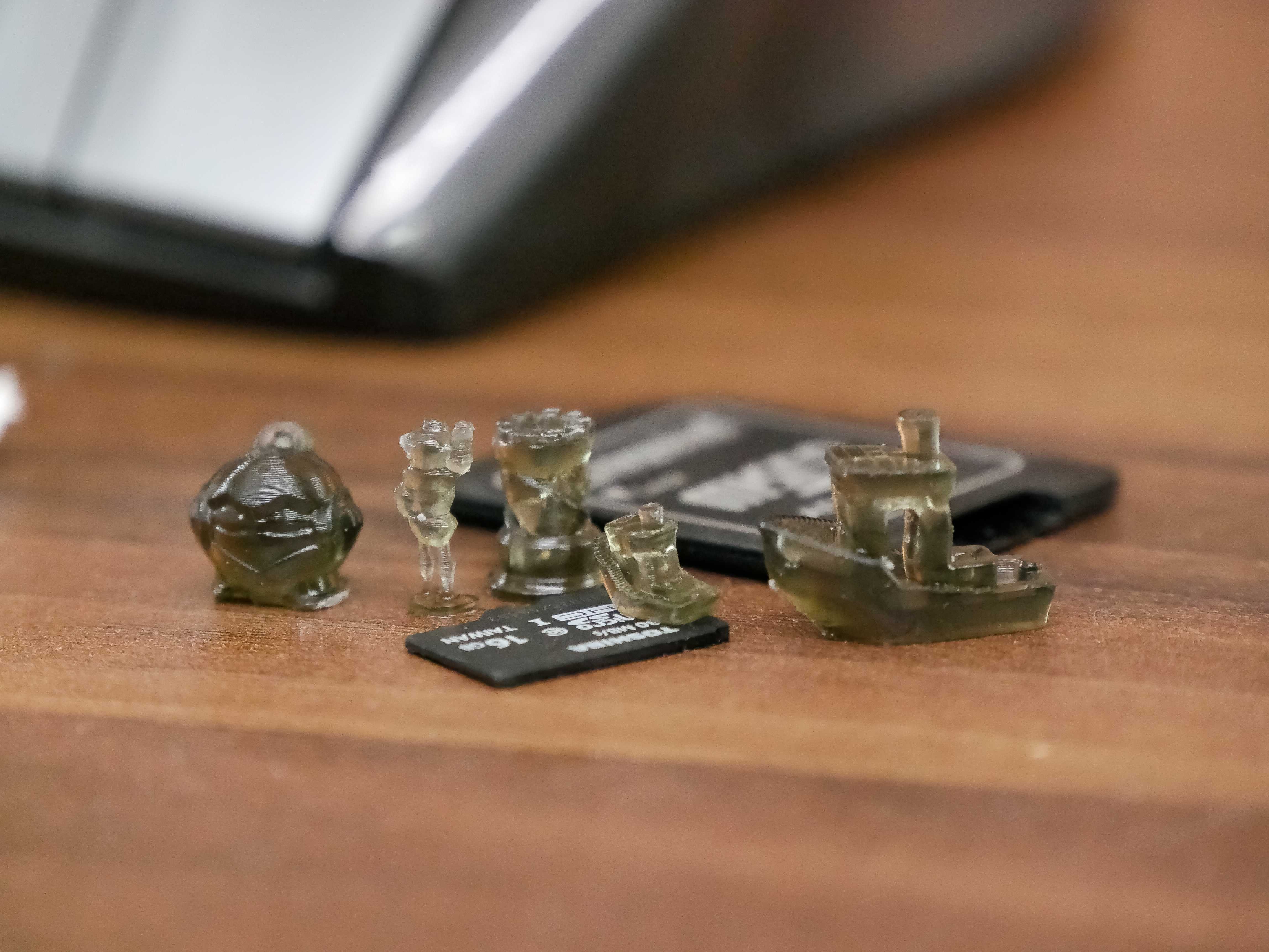

Great success on the Wanhao D7! First print, wrong print profile,
Great success on the Wanhao D7! First print, wrong print profile, lowest resolution possible - but it’s still super impressive how clean these tiny prints look!
Featuring:
RoboJoel at 11mm tall
3DBenchy at 25% and 12,5%
Tiny Make: rook
and a 3DHubs Marvin!

They look like gummies.
You should try again on high resolution
Show us a high res print.

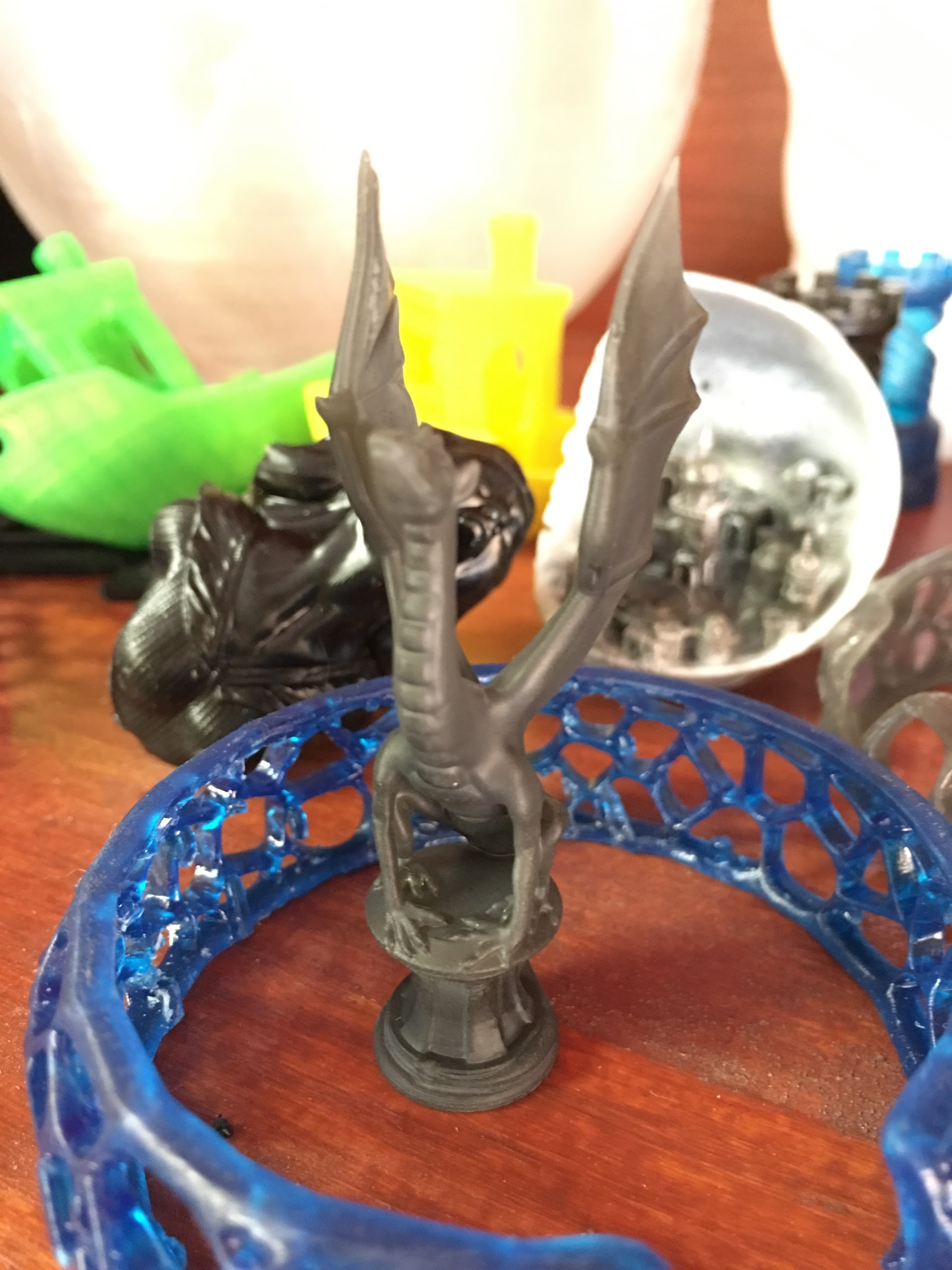

Loved the ambition of thinking you where going to keep your left hand clean and work with the right. Resin is a whole other monster with a steep learning curve. But the results are worth the effort. Getting accurate parts however are nearly impossible I can’t get within 0.1mm of the parts dimensions the wanhou resin will cure well at between 5 and 5,5 seconds But expect everything to be 0.1 -0.15 mm oversized also it can set as low as 4,5 seconds oh and that’s 50microns layers. At that cure time supports become very fragile.
Here’s 50micron prints I did with wanhou resin. The blue bangle is just big enough to slip over a wrist. Aria is 40mm high. https://plus.google.com/photos/
@Michael_Scholtz , your link takes me to me photos. It’s a generic Google photos link.
Lol same here I just seen a photo of a vase I made and thought Dan he made the same thing
Here it is
