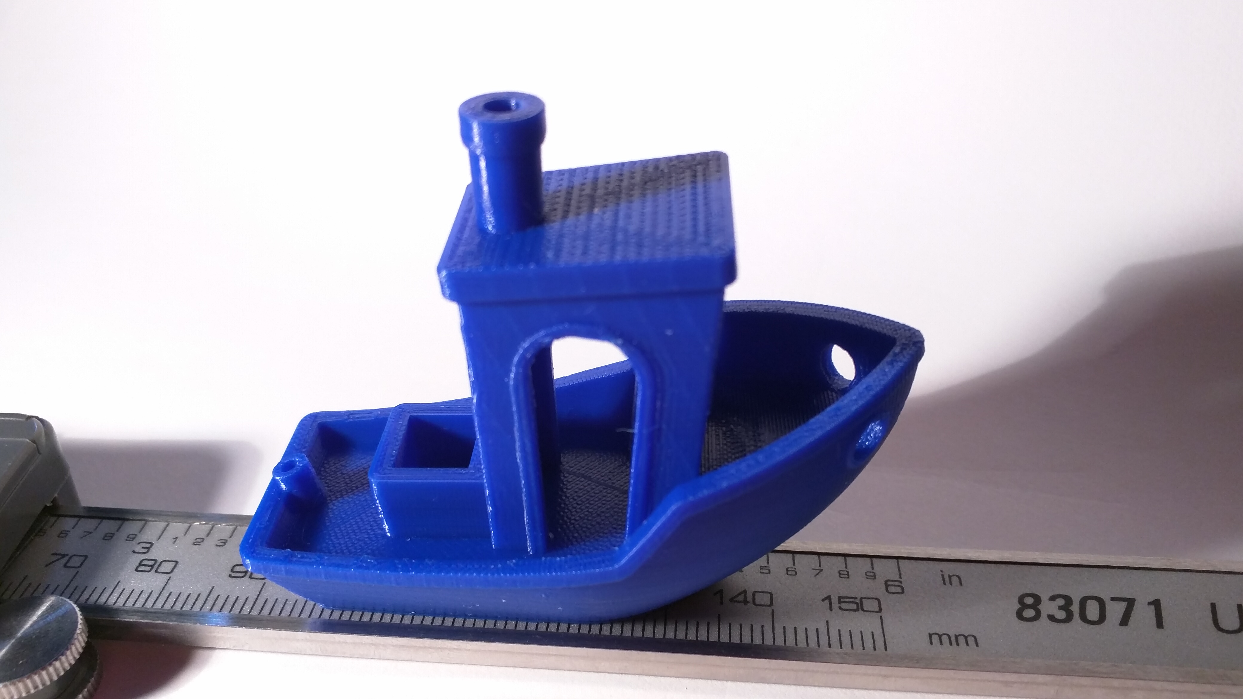

Greetings from Canada! I’ll try to post my new homemade printer again! I’m very satisfied with how it has turned out. It all began 5 years ago after building a Prusa Mendel and using it for a year. I drew up a square framed setup almost exactly like the current i3 but didn’t have time to do anything with the design until last fall. When looking on ebay for goodies I discovered the i3!!! Mine even had similar tab and slot design work similar to the laser cut models out there. Mine differs just by the lead paths into some cuts to reduce the wear and tear on my plasma system caused by too many pierces! The Mendels were getting pretty old so the design went into high gear and I’ve made 8 of them from my home shop. I’ve gone through 1 1/2 sheets of 4x8 ft 3/16 plate steel! They’re strong enough. Plasma systems, even when tuned and dialed-in, can’t provide the accuracy to place components that are meant to be jigged by their cut-in locations. What I did was allow for this by adding in slots for the machine screws and bolts rather than holes. Everything can be fine tuned and perfectly aligned. Also, as my diy plasma setup is a water table, surface hardening occurs and I had to allow for this in my design as fine grinding afterwards is a real pain! I bought everything off of ebay with free shipping and have spent $535 Canadian (terrible exchange rates, now) total, for each of 8 printers. My 3/16 plate steel frame uses 8mm smooth rod and 3/8" threaded rod for Y. An inductive sensor for Z mounts to an aluminium x-carraige I drew up and plasma cut and mig spool welded together. I used Chinese 8x8 leadscrews and their tops are floating (not retained in any way) and Geetek all-metal X ends. Marlin firmware and a Pi 2 running Octopi. @foosel has done an amazing job- thank you Gina! The printer runs sooo smoothly and quietly. i can’t believe how quiet it is. Just last week, I added 4 x Nema 17 Steel & Rubber Dampers to my motor mounts and now you can’t hear X or Y move, and Z just hums… sshhh… listen!
Very nice build! Gotta be one of the sharpest looking little 3DBenchy I’ve seen posted. What’s your printing speed?
@Alex_Wiebe Thank you. I’ ran this at 30mm/sec. The Hatchbox filament really helps sharpen it up. I have 3 enormous XXL rolls of Makerbot PLA and they don’t print as nicely as this.
