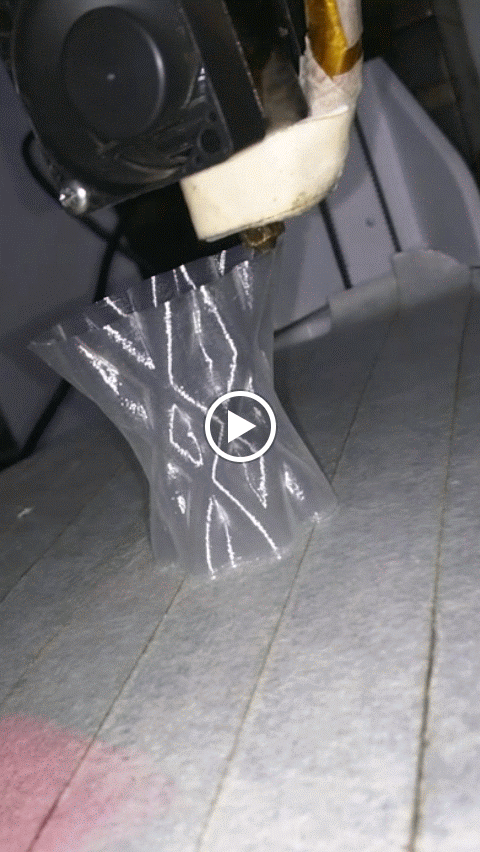

Beautiful work…!
How much does a machine like that cost.?
How much do the materials sprayed from the nossles cost.?
Do you know.?
Tower length 770mm, base length 370mm, rod length 32mm, 2020 alu extrusion, plate glass, nema17 hdb long, direct extruder stepper 20-by, pulley 36 tooth, gt2 belt, max speed 80mm/s (due to high and big not recommend using speed above 80mm/s, too much shaking)
@Scott_Hawkins ​, it cost about $284 for all, since i print most of part, and using second nema17 from old photocopy machine
Looks awesome! Could you show a couple more pictures of your prints? I’m curious!
Im making this for printing parts other 3D printer, hahaha
