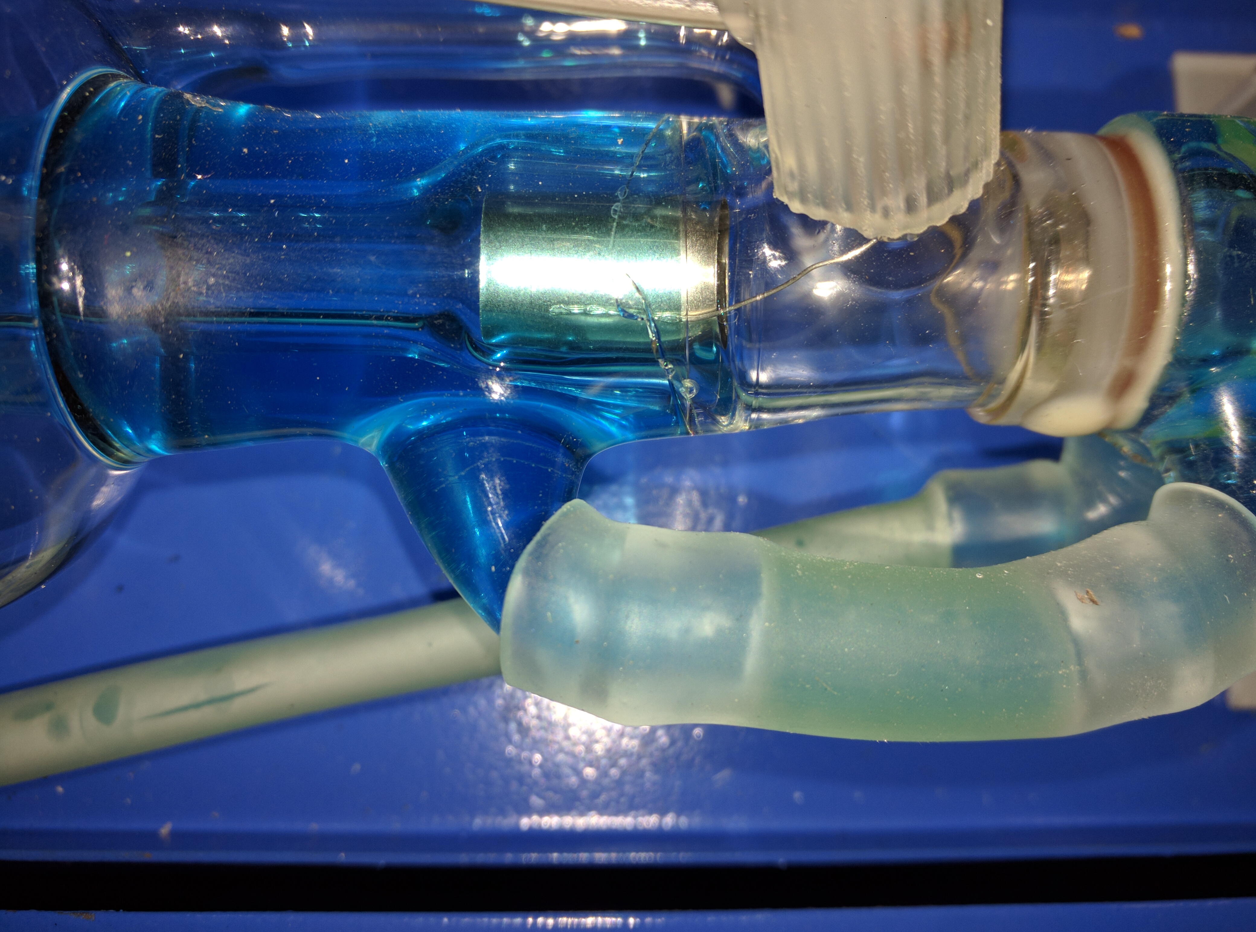

Guess I won't be doing anymore LaserWeb testing for a while.
Guess I won’t be doing anymore LaserWeb testing for a while. Just found this last night.
:open_mouth: how that happen? over heat or a bump in the night!
Not sure. Never been used without coolant flow or with any air bubbles.
could have over heated at the HV terminal, these tubes do not have the best cooling at the ends. even if you have a chiller
true but, these connectors are always horrible, i dont think you can do them nicely!
so glad we found tubes with screw terminals FTW :wink:
