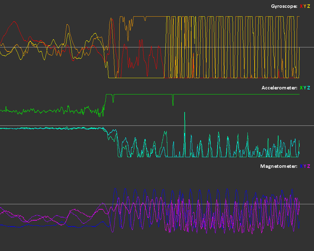

Guess what I’m playing with. I literally grabbed the USB cable attached to the Micro on a breadboard and started spinning the thing in mid-air. While it’s not an accurate test, it is giving me lots of pretty pictures to look at. I need to figure out exactly how to process the information here. I think I may also rig everything up inside of an untethered tube and see what kind of data I get then. I’ll have to figure out how to get the data. As much as I love watching live data, untethered means needing to log it first, process later. FYI, this is an LSM9DS0, three sensors in a tiny 4x4mm package.
