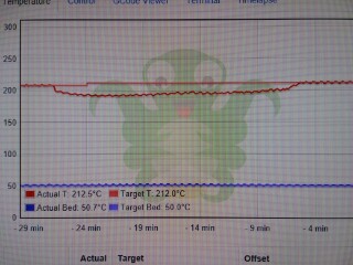

Guess when the blower fans booted up after the first layer… Must make better fan shrouds to direct airflow better
you need to do pid tunning with the fan on .
@ekaggrat_singh_kalsi ahh good idea
