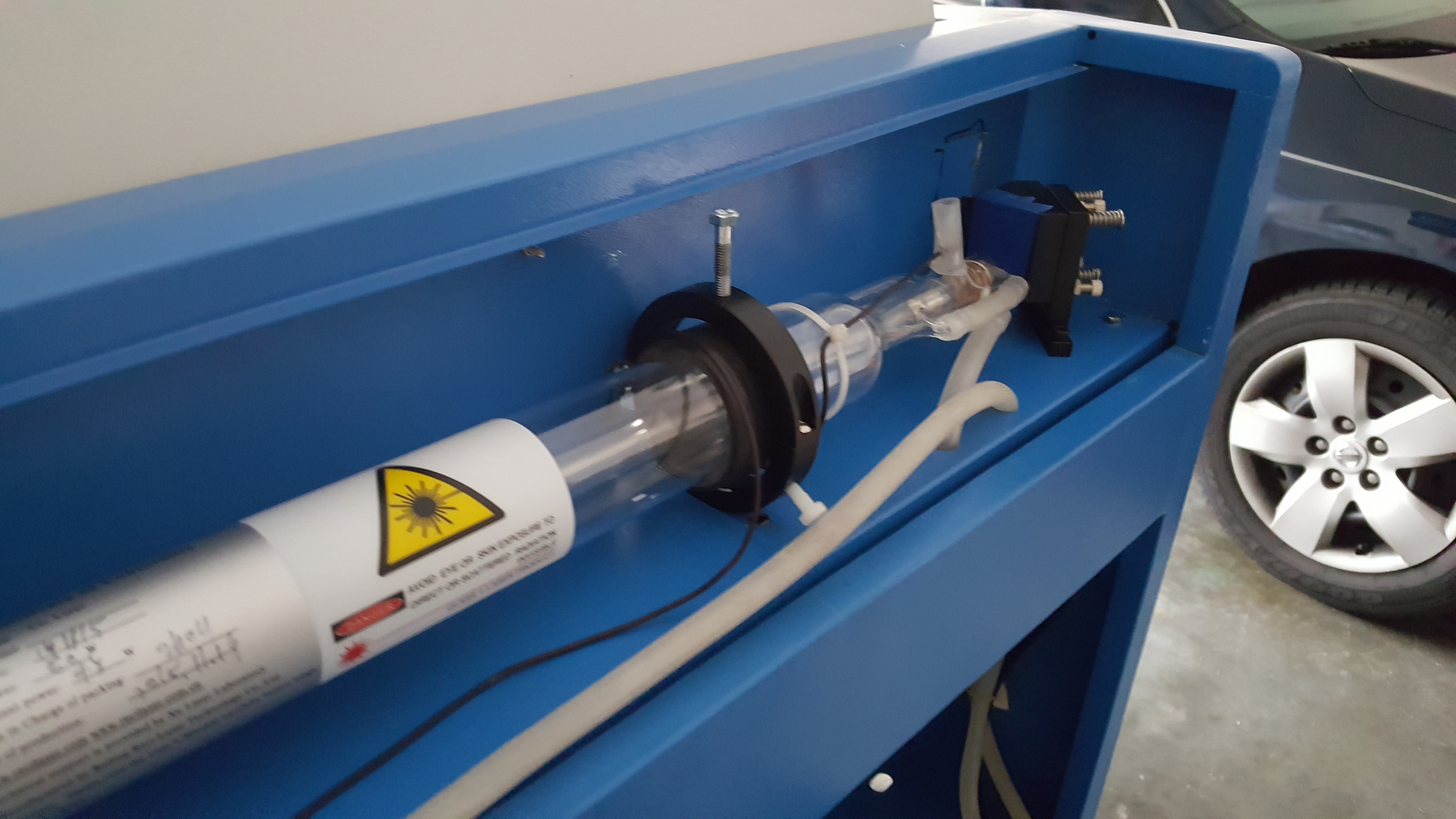

Gutted my 50 watt today...installed the light objects adjustable tube mounts in it.....it turned
Gutted my 50 watt today…installed the light objects adjustable tube mounts in it…it turned out great…not bad for 70 dollar investment…makes dialing in the tube a breeze!
That’s really cool. It would be useful to be able to make minor adjustments to the tube.
Look nice. I was thinking of upgrading to a larger diameter tube, and the mounts are one issue I didn’t see a easy rout around - adds up in a hurry, tube, power supply, etc.
I like those mounts, if not the price. (although they are probably worth it)
They could be made from aluminum tubing… I feel a lathe session coming on.
Bitchin photos man. You seem to have this handled bro. Shame you are not in the Dallas area.
Thanks guys…it’s been down for a week…I just got it up and running last night.
@Scott_Marshall …you can use a 2 1/2 inch lock collar to make one.
My tube barely fits between the wall and the mirror! I really need to tweak things a bit!
