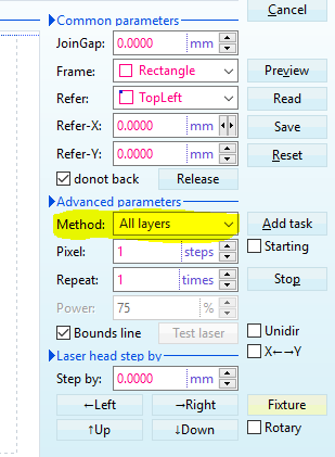

guys anyone know if you can disable the "hit ok to start new task"
guys anyone know if you can disable the “hit ok to start new task” in Corel draw? I want to be able to set it up to do 5 or 6 cuts without having to babysit it.
I think Method needs to be “All layers”
Pretty much the only way I managed (when I was on stock setup) was to set it up by clicking “Add Task” with the “Starting” checkbox disabled. Add all the required tasks to the queue. Then you click the “Play” button on the plugin system-tray right click menu. This allowed me to add the engrave to the queue, inside cuts to the queue, then outside cuts to the queue as 3 operations & then they would run in the order they were added to the queue.
Not a good idea to leave any laser machine as can catch fire
Not sure if I’d leave it completely unattended. But if you want you can "add task"s one at a time, then on the last one check “starting” and hit add task.
