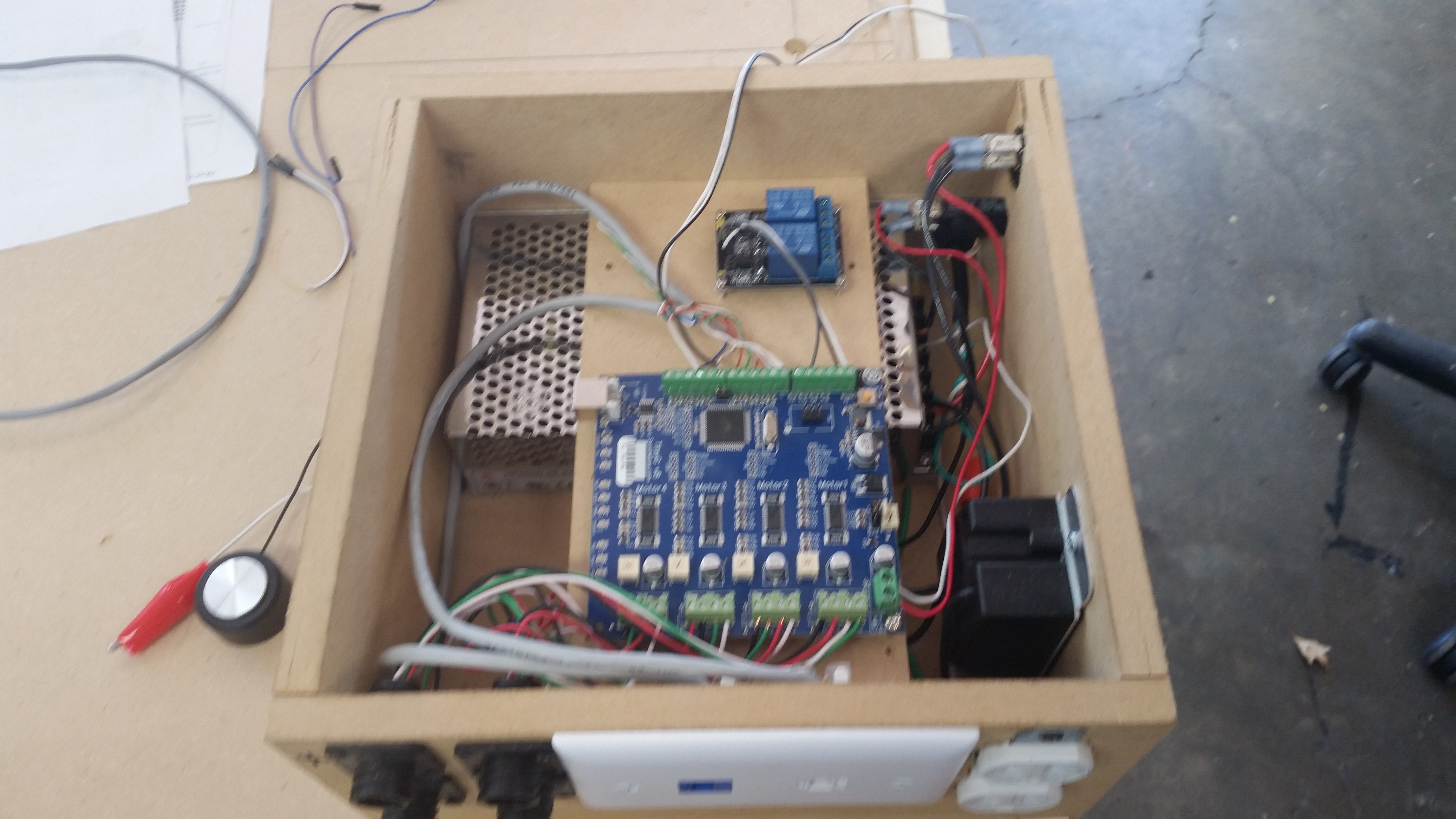

Guys , Do you see any reason way I can not use pwm to control the high voltage relay one side of it to turn on the spindle and the other side of the relay to turn on my shop vac ? The high voltage relay is rated for 10amp per relay.
Its an ac motor right? From my experience pwm and ac pulsing mains is not advisable. Unless I misunderstand you.
Yes , it is a ac motor, I know that I can
Riley is correct. There are two possible issues with your setup: it looks like you’re using mechanical relays and they’re not suited for rapid switching. PWM systems can pulse from 500Hz to many thousand times per second and only a solid state relay is designed for that type of fast switching.
Next, PWM of a DC motor is simple because you only have to account for voltage and time (aka the duty cycle). For AC motors, you have to account for voltage, time, and frequency. Without taking frequency into account, a PWM AC system is unreliable.
Kurt, I apologize, I explained what wouldn’t doesn’t work without explaining what does: if you replace the relay with a SCR or Triac circuit then you’ll be able to PWM the gate of the SCR/Triac and that will effectively control the speed of the AC motor. I have a 40A solid state relay from SparkFun and the data sheet mentions that you can create an AC variable resistor by controlling the trigger angle of the Triac.

Kurt, just to save you from a potentially dangerous test, the answer to your question is no, 100% PWM is NOT the same as the circuit being on 100% of the time. Typically the PWM is clocked at some speed and the percentage is the amount of time the circuit is on, but there is always a transition to off and back on again, so 100% is the maximum time it’ll stay on while still having a duty cycle. This would make a relay unhappy at best. One of the solid state options tied to one of the tinyg pins is the way to go…

Sorry, I did not see your picture or prior suggestions, so most of mine are redundant.
But, now seeing the relays you are using (I have similar in my drawer), I caution you to look not at the Amp rating on the relays, rather their HP rating. Some small relays cannot handle motor start surges well. The 10A relay I just checked has no HP rating, so ? Just be aware it may not last long.
I also feel compelled to comment on Neal’s SCR/Triac idea - yes, could be done but would be a non trivial circuit to ensure safety and isolate tinyG from AC mains.
The best solution likely a SSR https://www.sparkfun.com/products/10636 is an example, not necessarily a recommendation
