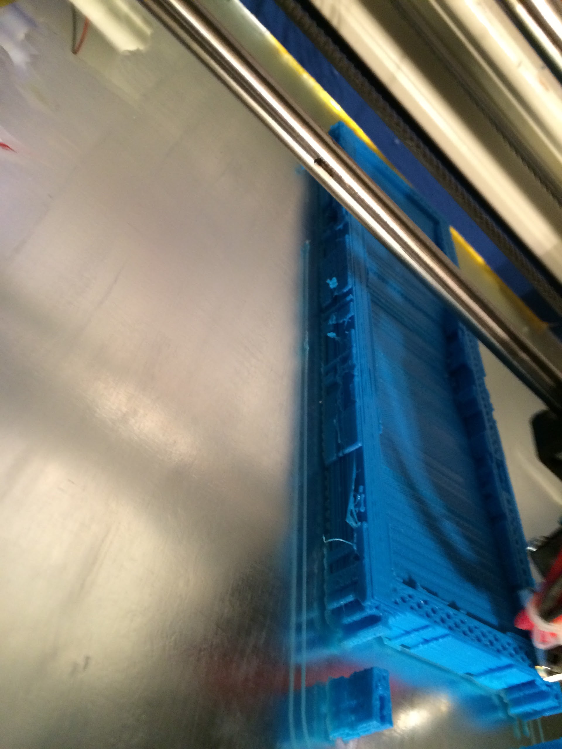

Guys, having an issue I have not faced in a long time and at my wit’s end. Running Repetier 1.0, slic3r 1.1.6, and E3D v6. The filament is PLA and running at 186 degrees. My feed is adequately pushing as I am leaving slight marks on the filament. I have perfectly tuned retraction, and esteps/mm.
The issue is, the machine randomly skips layers. There is no consistency, such as z ribbing or high acceleration or jerk would provide. The filament is running perfect out of the nozzle on test and calibration pieces, but when I go to print the model I have this issue. The image shows all the skipping layers behind the support.
Looking for any ideas here.

The only reason I am slightly hesitant about it being a z axis travel issue is due to the fact I can print a 50 mm tall hollow box and it is seamless and flawless. I can print a 20mm filled box in one corner and a hollow in the other and still flawless.
I have tried heavy z retracts, additional added to length post retraction, varying temp to filament, speeds, accelerations, layer heights. The issue remains.
I am leaning towards attempting to redraw, manually support, and run through cura and kisslicer. Just a little discouraged as I have always been able to get my printress to act right. The only change this time is the supports (pillars) and a brand new V6 hotend, I really hope it’s not the latter.

What do you mean by skipping layers? Is plastic missing? Or is the Z axis not moving?
If you post images of the sides of your prints up closer and tag me in I’ll be able to see if it’s an extrusion issue or hotend related.
@Markus_Granberg I sliced with curaengine last night. It really was beyond easy. Post slicing I ran through the preview in Repetier layer by layer and found a funny layer around 67 of 580. The layer shows a solid, but travel does not line up. I was hesitant to proceed, resliced with Slic3r and tried a few other things, same results, so I guess I’ll try to run it as i do not have much to loose.
