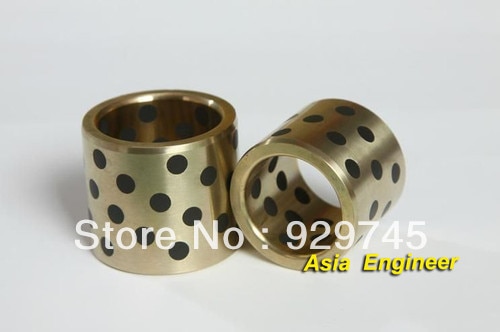

How important is the quality of the bearings? What do you think about these: http://www.aliexpress.com/item/10-mm-bearing-kirksite-bearing-insert-bearing-with-housing-KP000-pillow-block-bearing/1121200956.html
If you mean to use it on the sliders, those are pillow block bearings and are used to support rotating shafts. In the eustathios, the slider bearings need to support a rotating shaft and also allow linear motion. They also look very heavy. You will want this instead, though they’re not much cheaper.
If you mean to use it as the support for the z-axis threaded rods, they will work with some modifications to the printed parts.
I was thinking of using those to hold the 10mm rods (instead of the eight 3d printed holders).
@Shachar_Weis the frame would require adjustment. The bearing you linked will not fit in the standard frame.
Ah, good point.
