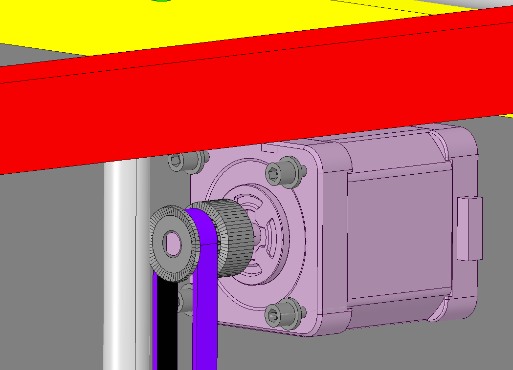

Guys, how would you mount a stepper motor under and along a square tube like shown in the pic below? I am not very confident in my current design as it is (http://www.thingiverse.com/thing:1487375).
Please don’t suggest extrusion (I have that in works), I am interested in doing this variation with square tubing.

I just don’t trust that much my design for the Z motor mount… it will rock around the plane where the screws go through the plastic into the motor as the motor changes rotation direction. Granted, it shouldn’t happen with a level bed where auto-level compensation is not employed and the load would basically be in one direction only as the bed descends layer by layer…
I would use a formed sheet metal piece. Its the only way to securely place and secure a motor like this. We normally do a custom one however I have idea if you can get an off the shelf piece.
@Rob_Palmer
I asked how would you do it to pick your brains regardless of my wishes. I need a simple way (plastic or metal) that would securely mount the motor to the above square tubing without being too flimsy during normal operation.
I have also specified one constrain and that is that I would like not to put holes through the tube but to use some sort of clamping for the job.

I don’t get it, after your first answer I said I want to go around the tube (clamp?) as I don’t want to put holes through the alu square.
And I appreciate all the answers, I don’t necessarily want the answers I am also able to imagine, but something that I might not think of or not know about.

A flared out U-bracket would work, something along these lines: http://cdn1.bigcommerce.com/n-ww20x/2454y/product_images/uploaded_images/joist-hanger-4.jpg. I’d have one on each end of the Nema17.
I’ve tried some quick sketching so maybe something like this?: https://is.gd/zk6q92
