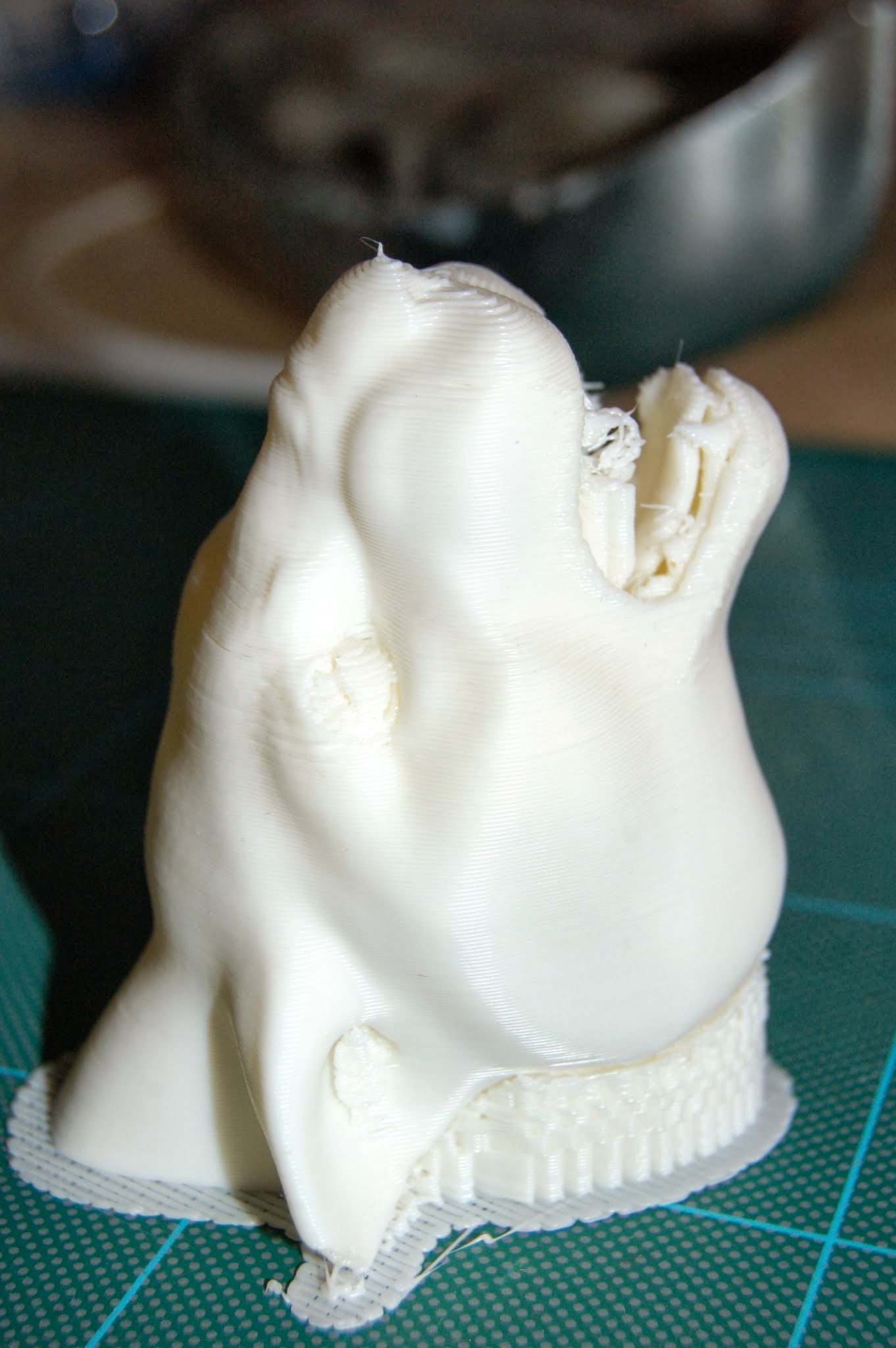

Guys, i printed this today.  abs-kisslicer (ultra support), 0.35 jhead, 50mm/s.
Critics, comments??
Looks good. I wonder how we could improve the resolution of those top layers though.
Maybe an automated function to make the layers on top gradually thinner?
with slic3r you can do different layers height for different z values.
i will print it again later, sliced with slic3r @0.25mm layers
Awesome! What do you do with it now?
Bit of time in an acetone vapour bath would sort those top layers out.
thanks!
@Testa_Atset , its a demo piece for a client.
