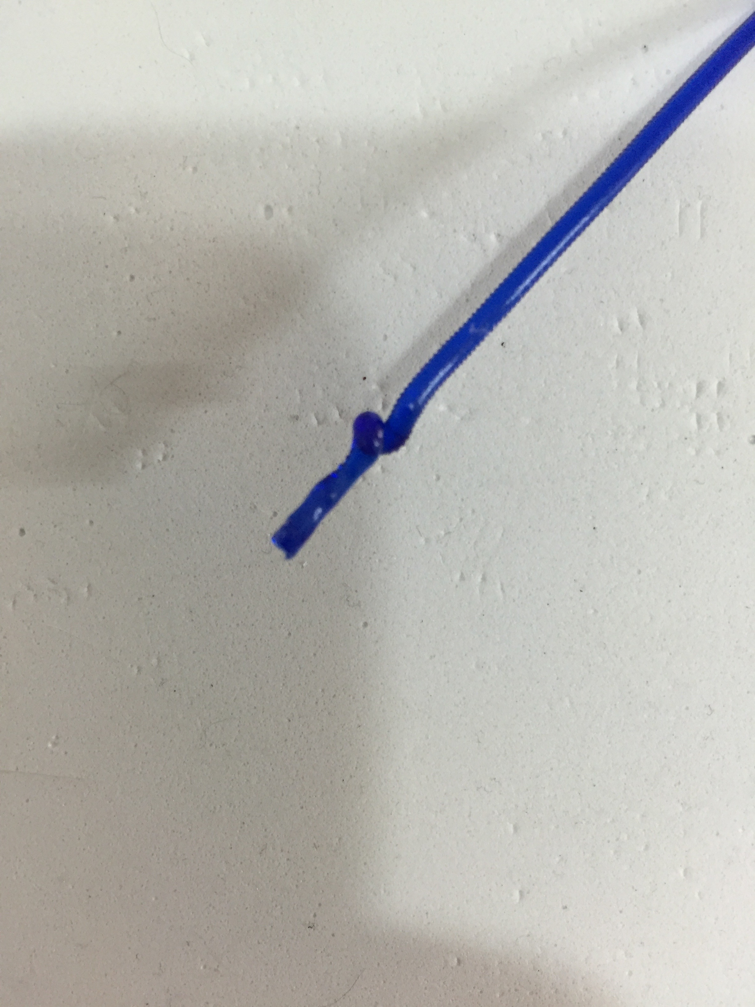

I tried it with 0.4 and 0.6mm nozzle which doesn’t seem to make a difference and as far as i could investigate the problem sits above the nozzle. After printing ok for quite a while the filament extrusion stops, i hear the extruder losing steps or fighting any other problem. The result then mostly is because of the enormous grip from the Bondtech extruder the filament gets folded and knoted inside the extruder. I’ve attached an image to show what it looks like. This happens just below the upper “outlet” of the bowden tube. I think this is not the cause of the problem but just the result. After seeing this i pulled out the bowden tube from the extruder, pulled the filament out the tube and tried to hand push it through the extruder to find out if there’s some clogging in there… nothing. Could move it nice and smooth.

To get high speeds on Esun PETG I run 255C for my hot end temp. Can you confirm what temps you are running. If it jams like that, you have a greater back pressure than the compression strength of the filament and it buckles. So I say slow down, or up the temp first.
I only have this problem when my hot end temp is not within range of the filament OR my heat break and nozzle gets junk in them. I have spare heat breaks and nozzle and swapping them out typically fixes this problem. I torch the dirty ones and clean them with acetone. What I really need to do is find a way to measure the amperage of the stepper on the extruder so it can indicate how hard it is working. It will take a large force and amp draw to bend that filament in a confined space. With a feedback sensor it would be nice to have and kill the job because no printing will happen with a mangled filament.
thanks guys. this is all highly valuable input. I think I’m good with the temps, but I will test playing with them. @Eclsnowman Bowden tube indeed is something I’m not lucky with yet. don’t think I have a radius that is too tight but I’m not lucky with the fact that it’s not a stable arc at all. I will shorten it down a bit and try to find a way to control how it moves a bit more.
