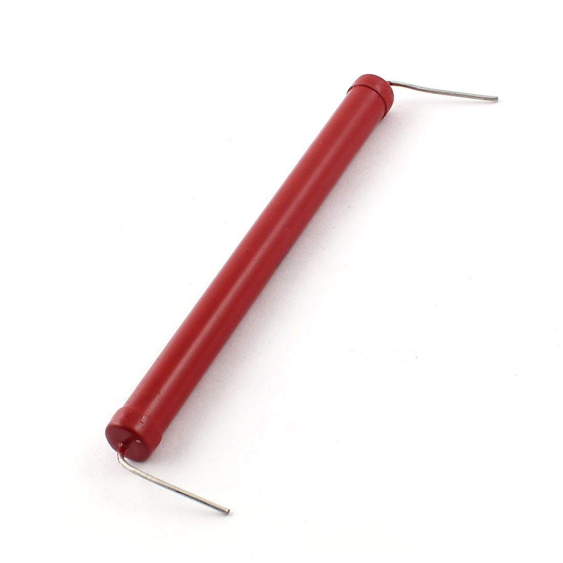

It seems that we as community we should come up with a safe way to test LVPS’s. I see lots of posts where during troubleshooting it is necessary to isolate a bad LPS from the Laser.
Essentially we would need a DIY HV probe that will work with a DVM and some published values that indicate good-bad. You can buy probes but they are expensive.

Measuring current and voltage in CO2 laser tube - YouTube, this uses 10x 47meg resistors enclosed in a shop made probe.
You can get some HV resistors here:
