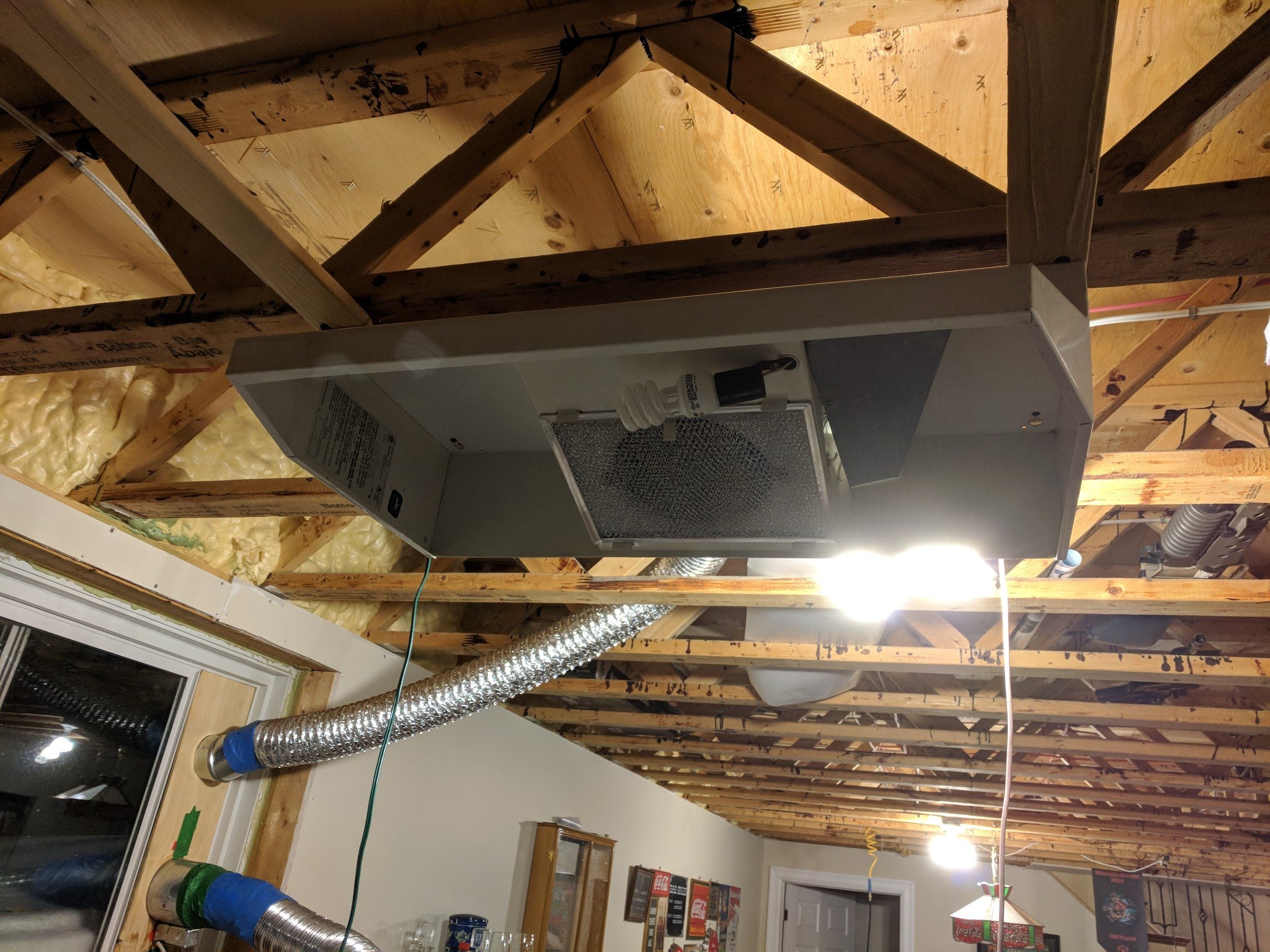

A cooker hood is probably a more effective defence than a bathroom fan.

So I went and took your guys advice and got a range hood for the K40. It works really well. The smell from the mdf are way lower. I just have to clean out the workshop to cut down on the old dust/materials.
