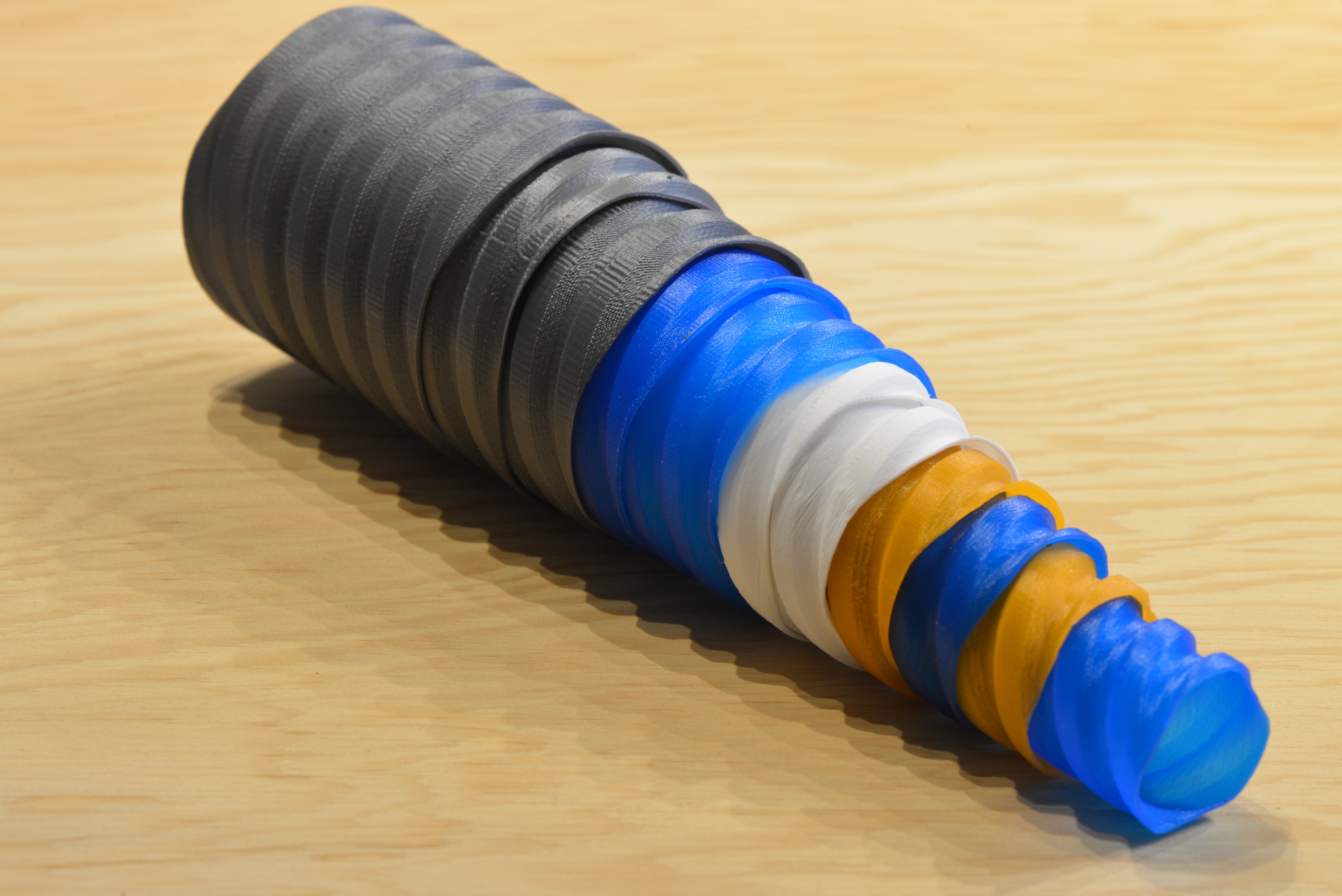

Hacked up some code to directly generate GCode for a little fun stuff:
Hacked up some code to directly generate GCode for a little fun stuff: creating multiple screws that can nest into each other. The screw-configuration (e.g. number of threads and how thick they are) can be configured.
These screws are not sliced into layers, but printed in one go in a ‘vase’-like print. Multiple screws fit on the same build-platform. Since they are built in sequence, they are diagonally staggered so that the hotend doesn’t knock over the previous piece.
Have fun.
