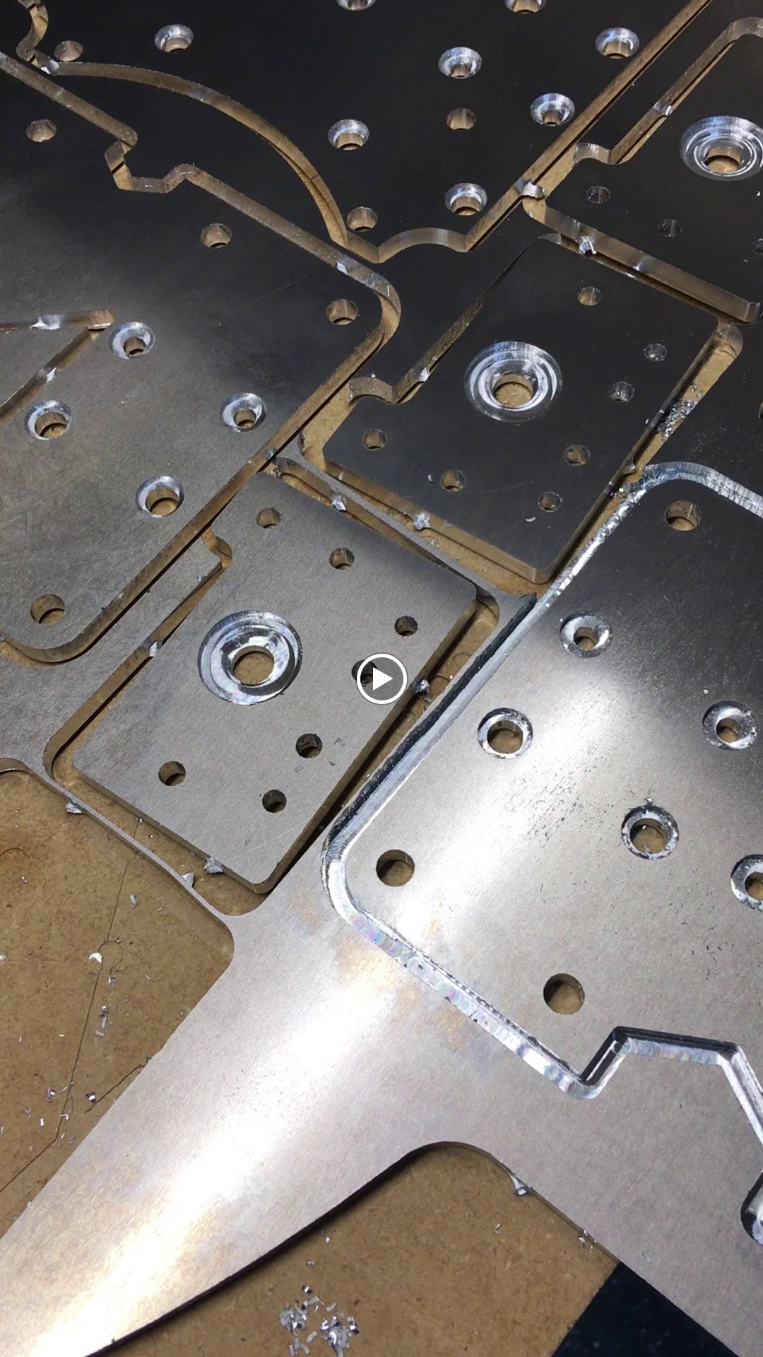

Had a good laugh to myself this morning. Thought I'd post.

May I ask the particulars of speeds, feeds, depth of cuts and what bit is used?
@Colin_Kaminski travel at 600mm/m dive at 6mm/m .6 mm DoC
Smw3D’s 4mm single flute end mill.
@Brandon_Satterfield Thank you! I am going to cut some aluminum this week.
@Brandon_Satterfield you might want to mention the spindle speed for the last piece of the recipe puzzle :slight_smile:
@Eclsnowman true! Sorry forgot that part.
15k Rpm above.
