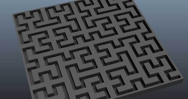

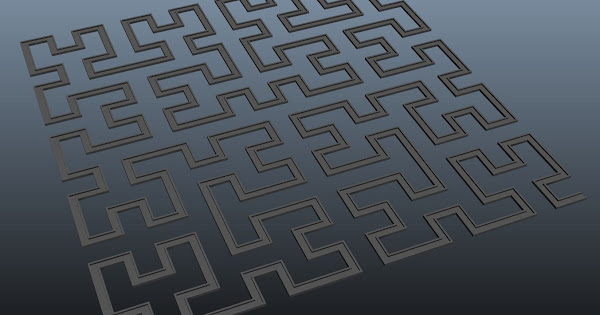

guide:
Google Photos
full diffusive frame (assuming it’s printed with clear pla or something similar)
Google Photos
lsystems are perfectly suited for this kind of thing because of the way they’re drawn too. you specify a segment length, and if that length is equal to that of a segment of led strip, then you can be sure you’re always bending it evenly between leds. :slight_smile:
I generated these with an lsystems node in touch designer then exported obj data, and took that into maya and modeled it up a bit more to be suitable for printing

I would have totally spent the extra 2-3 hours taken to print the strip guide up to the width of the strip so I could have just stuck them in there rather than painstakingly glue / bend, every segment of strip.
it would have also diffused it better too (see second link above.)
other than that, I measured and generated everything to scale in 3d up front, and based my number of lsystem generations off of what ever was closest to 4 meters of led strips to minimize cutting and soldering.
