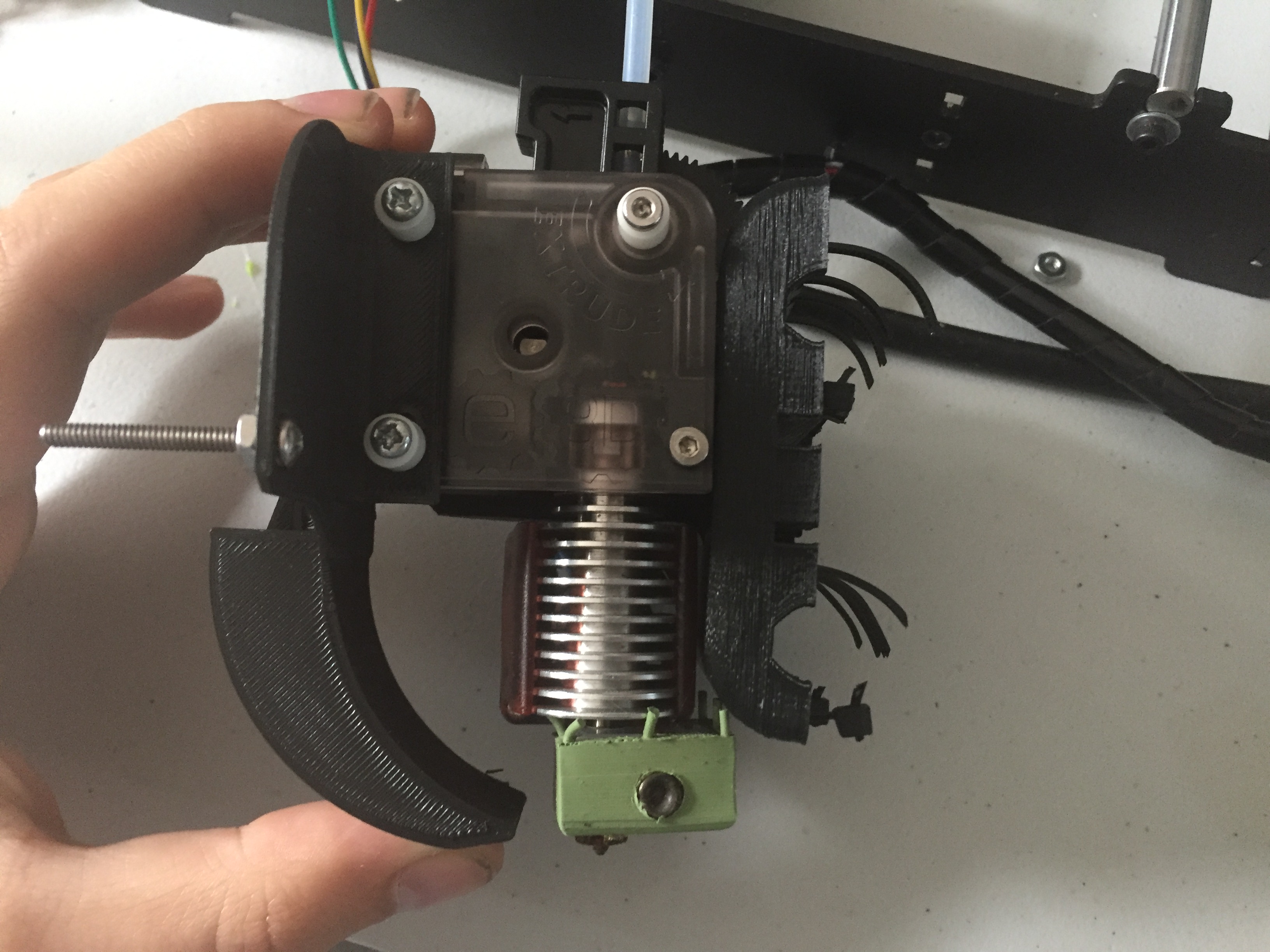

I’m reworking a P3Steel and multiple Wanhao Di3’s. I’ve gotten quite fond of the Titan aero for that application.

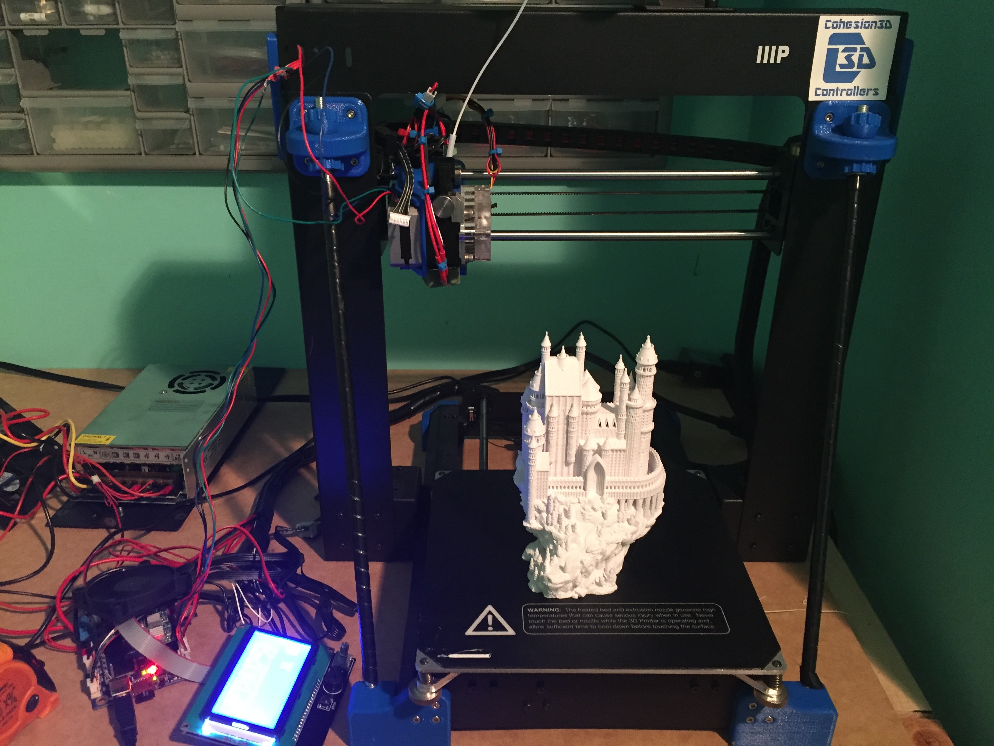

Right? In theory what could go wrong? Haha…also, man I’ve always wanted to print that castle, but never imagined I could get the detail so good. Great job.
It was a last minute print for Maker Faire. Took 18 hours. Then someone at the faire walked off with it. Oh well, plastic is cheap.

The P3Steel had a Titan + v6 before, but I wasn’t very happy with where I had to put the cooling fan and a bunch of other little things, so figured I’ll keep going with the aeros. The quality was phenomenal from this head too though, for a while the P3Steel was my main/ best printer.
