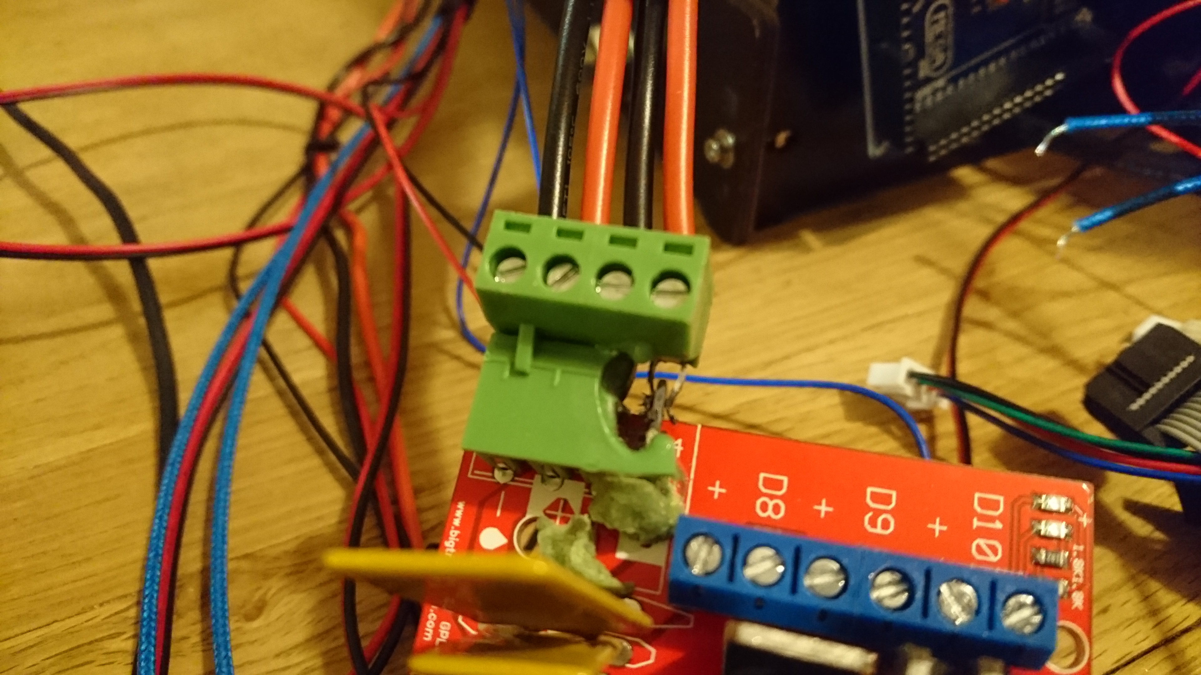

Had an interesting evening yesterday. Luckily I was sat next to the printer waiting for it to heat up before starting the print. So as soon as I saw the smoke I could cut the power. Being new to the 3D printing world I wasn’t aware of the problem with these green connectors being underrated, so it came as quite a surprise when it started smoking :frowning: Why are they still making these boards with these connectors?
Anyway I used my (not very good) soldering skills to remove the connector block and solder the wires directly to the board and all still works.

I keep seeing that connector toasted on other people’s printers. I hard-wired mine for peace of mind.

By the way, even if the current draw is kept below the nominal connector rating (which isn’t always the case) it is 99.99% universally true in 3d printer designs that the proper de-rating factors have not been applied. For example, a 15A connector is only good for 15A through ONE pin at a time. But you’ve got power flowing to and from the PSU, and each pin is heating the others, so you have to de-rate the connector to a significantly lower max current.
Another big issue is connectors on heatbeds. They have to be de-rated for the ambient temp at the connector, which in some cases even de-rates them to zero amps!
