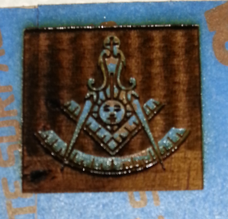

Had an interesting observation with my machine today. Was reverse engraving a small image on 3mm Alder and noticed these stripes forming in the engraved background. 15% power at 175 mm/s. The regular straight lines were puzzling and were not related to the grain of the wood. Checked all mirrors and lens and made sure everything was tight. Started the engrave over and the stripes where still there. Looked down at my airbrush compressor, which sits on the bottom shelf under the laser, picked it up and sat it on the floor. At which point the stripes stopped forming, as you see in the pic, and I knew immediately what was happening. Confirmed it by measuring the stripe spacing which was almost 3mm which gives almost exactly 60 cycles per 175mm (175 mm/s engrave speed). The air compressor operates at the US power line freq of 60hz and was causing the light piece of wood to vibrate around the focus point of the laser at 60hz. So engrave speeds that are around multiples, or sub-multiples, of your power line freq are going to be susceptible to this phenomenon.

They could easily be produced by stepper motor vibration being transmitted to a loose mirror as well. Knowing that vibration is the cause makes it infinitely easier to run down the exact source of the problem and to fix it.

Moray pattern sounded familiar so I had to google it, so it’s moire pattern which is french for a type of pattern seen in certain fabrics. Normally this is caused by two overlapping sets of parallel lines where one set is at a angle to the other set. The pattern I’m seeing with the laser etching looks like a classic moire pattern but the actual cause of the lines is by a different effect. When I look at the etching under magnification the bright areas are smooth while the dark areas are very thin fins of wood with only one set of parallel lines. I’m hypothesizing that, as the workpiece vibrates up and down, the dark areas are more in focus while the light areas are slightly out of focus causing the wider beam to overlap the previous raster line more so you get no fins. My bed is made from an expanded metal sheet which does have a small amount of flex to it which is probably enhancing the vibration of the piece being etched.
Makes sense to me, the vibration is more of a start/stop rather than a interaction.
