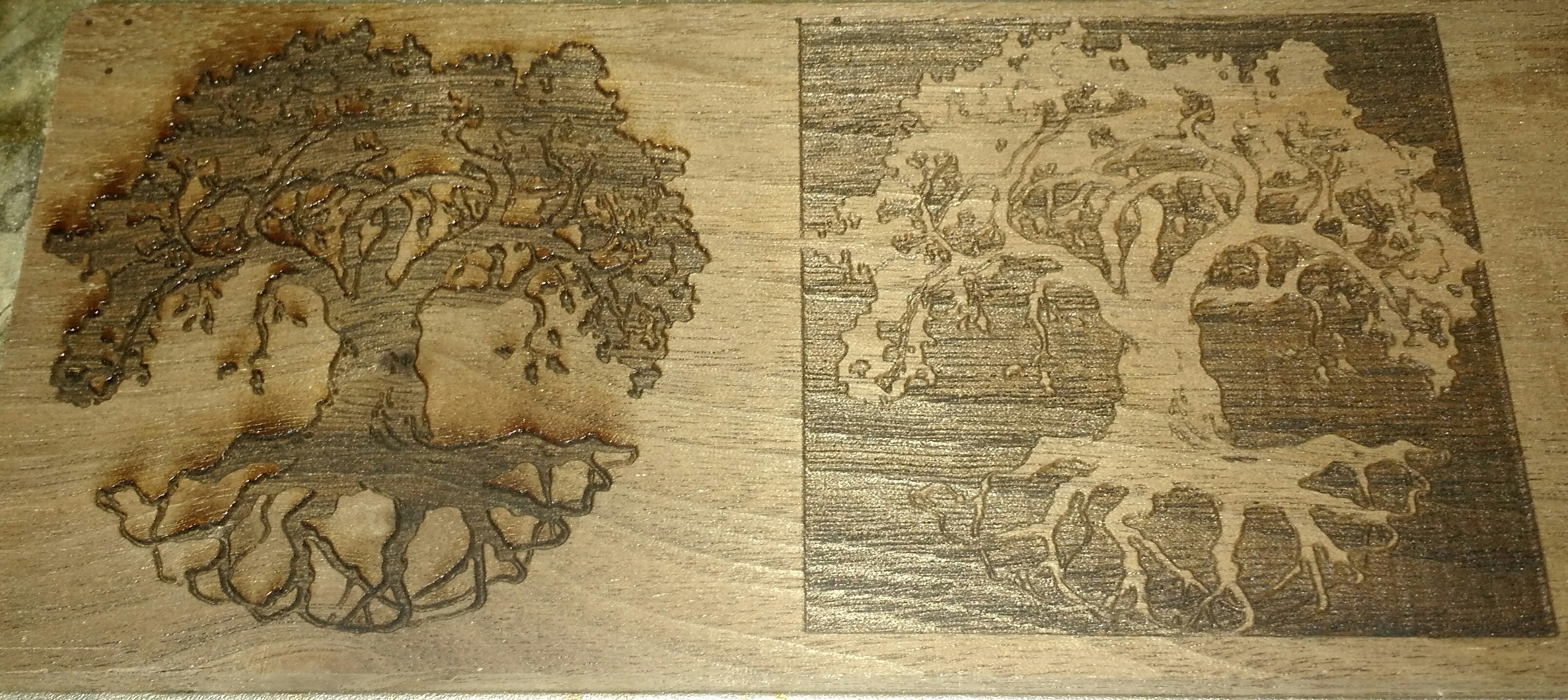

Had some black walnut laying around. So far I like the results
Looks pretty nice Alex.
Nice ,how long did 1 take,what power and ma
One on the left 300mm/s at 9ma, one on the right was 500mm/s 9ma just a few minutes each
2.5 X 2.5 inches
Are u using stock circuit board? ,the ladt thing i etched took 45 min at 250mm/sec and 5ma ,have yet to test faster speeded, worried about vibrations
Forget to say size 15 cm x 10cm
Looks great @Alex_Krause . Looks like a nice wood to work with.
@Phillip_Conroy Vibrations are fine with engraving all the way up to 500mm/s. Not so with cutting however.
I typically run between 300-500mm/s on all engraves. And yes stock M2nano for just a short period of time I found out I needed to order a few more components before I switch to smoothie
