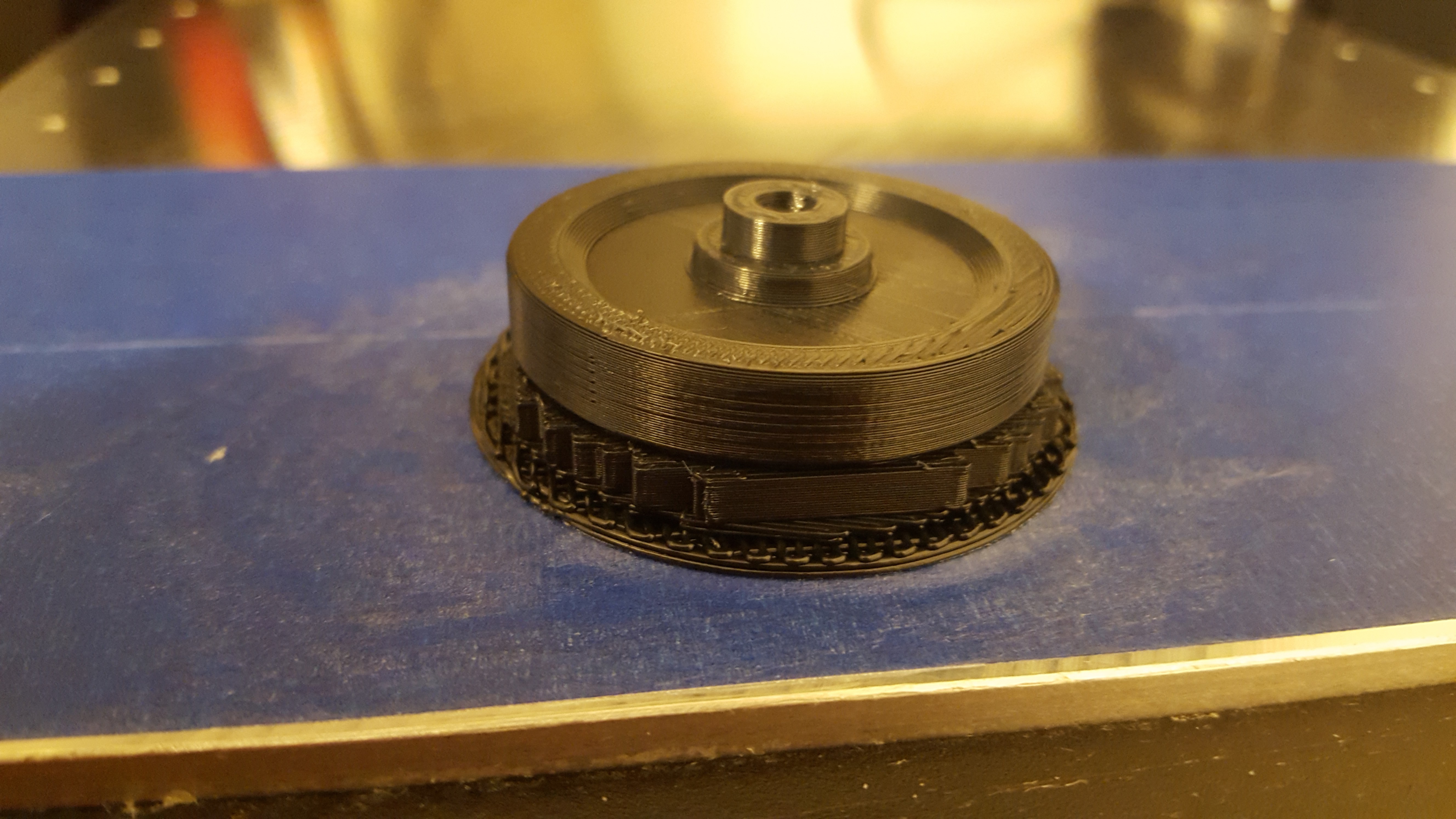

Had to do some ABS printing this weekend,
Had to do some ABS printing this weekend, was concerned about bed adhesion since I’ve removed my Kapton tape. My PrintrBot+ bed doesn’t want to go above 80deg and the prints don’t want to stick to the bare aluminum even with hairspray or glue sticks. So I tried blue painters tape, but ABS warped immediately, so I ended up using blue painters tape with a good application of my glue stick and it works perfectly!
My Kapton tape was pretty beat up and even with glue sticks or hairspray ABS always warped a bit, and painters tape didn’t stick very well to it. What I’ve found is, painters tape (especially blue) sticks much better to bare aluminum. I was thinking of getting Buildtak but I’m having great luck with painters tape on my aluminum bed, going to try a large ABS part next to see if it can handle that.

@Griffin_Paquette I print very little ABS, can’t stand the smell.
Wow look at that support material. I hate support material.
@Scottie_D369 I’m in the same boat, I usually try to avoid it if at all possible, but I couldn’t in this case and was pleasantly surprised at how well it turned out.
